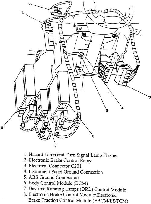

Jason B's Avatar
Joined: May 2015
Posts: 95
From: Long Island, New York
Here are a few ground locations to check.
and you're right it seems as though the previous info from the other grounds is either wrong or mislabeled. Sorry about that :/
