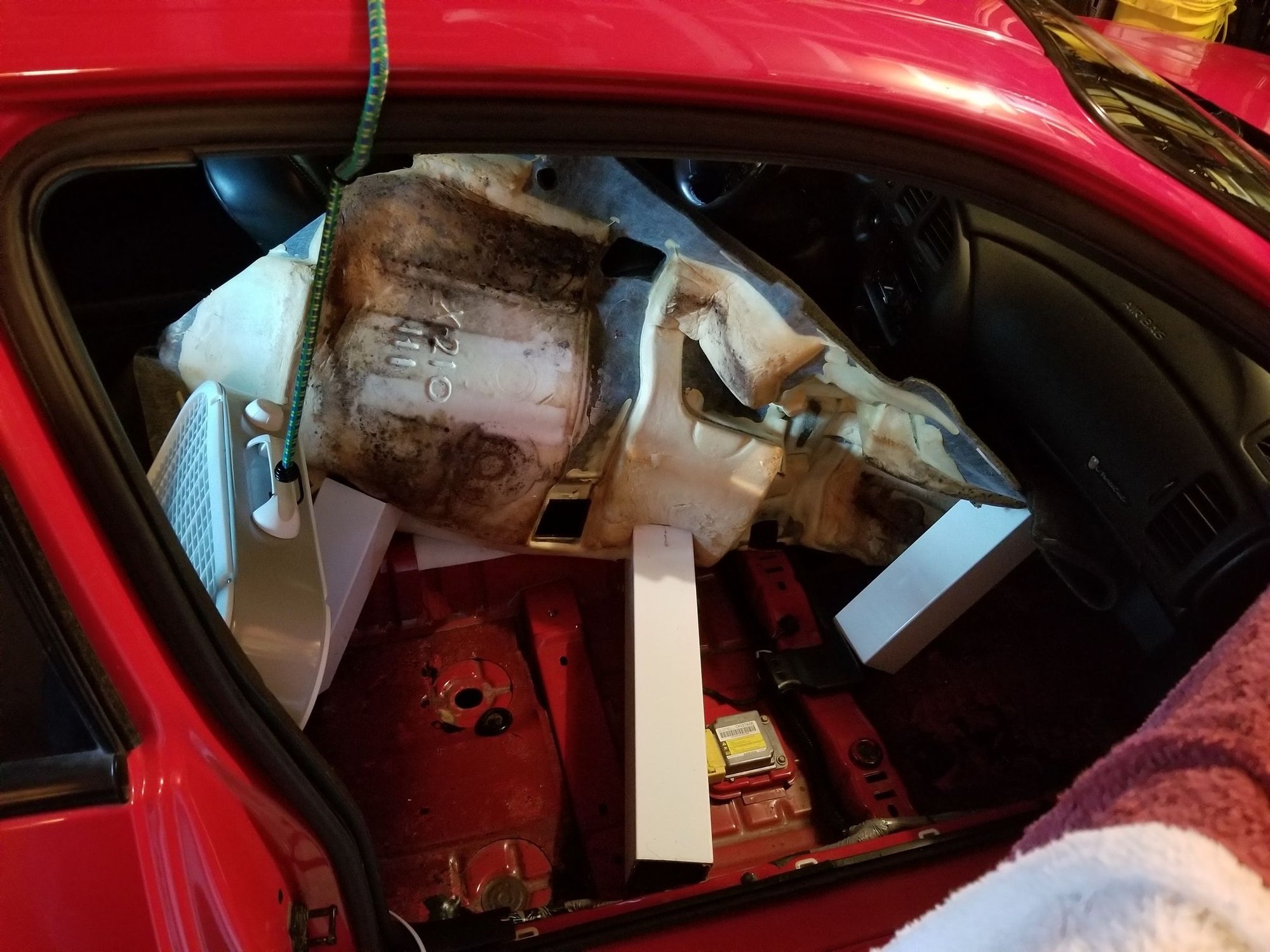

What I'm worried about is whether or not a fan is really going to affect the soggy foam. Here's a picture of what I mean:
Pretty sure the discoloration is just rust and age, but that foam stuck to the carpet is soggy every time I touch it. I just swapped out the towels I had stuffed in there while I took this picture and they were soaked through. Not dripping, but no part was dry.
Honestly thinking about pulling both seats and all the carpet out, peeling off the spray foam, letting it all dry out, and putting a layer of FatMat under the entire thing. Won't provide the structure that the spray foam does, but it'll be something.
Unless y'all think the foam will actually dry out eventually (under a box-fan for a day or two)?

The foam will dry out if you pull if you pull the carpet out and put a fan on it Picture didn't post

Thanks, @ZIPPY02. That last part is exactly what I ended up doing (since it was only on the passenger side). We went out of town for a few days, so before we left, I supported the carpet from underneath and aimed a box fan (held up by a bungee cord through the sunroof) at the floor. Left it running the entire time. Now we're back and everything seems to be really dry. The foam I was practically "milking" for water before is dry to the touch and nothing leaks out when it's given a firm squeeze.
NOTE: I also found two rubber plugs in the floor under the carpet and removed them while squeezing water out before we left. Might actually leave those out, just in case the cabin air filter gasket comes loose again.
