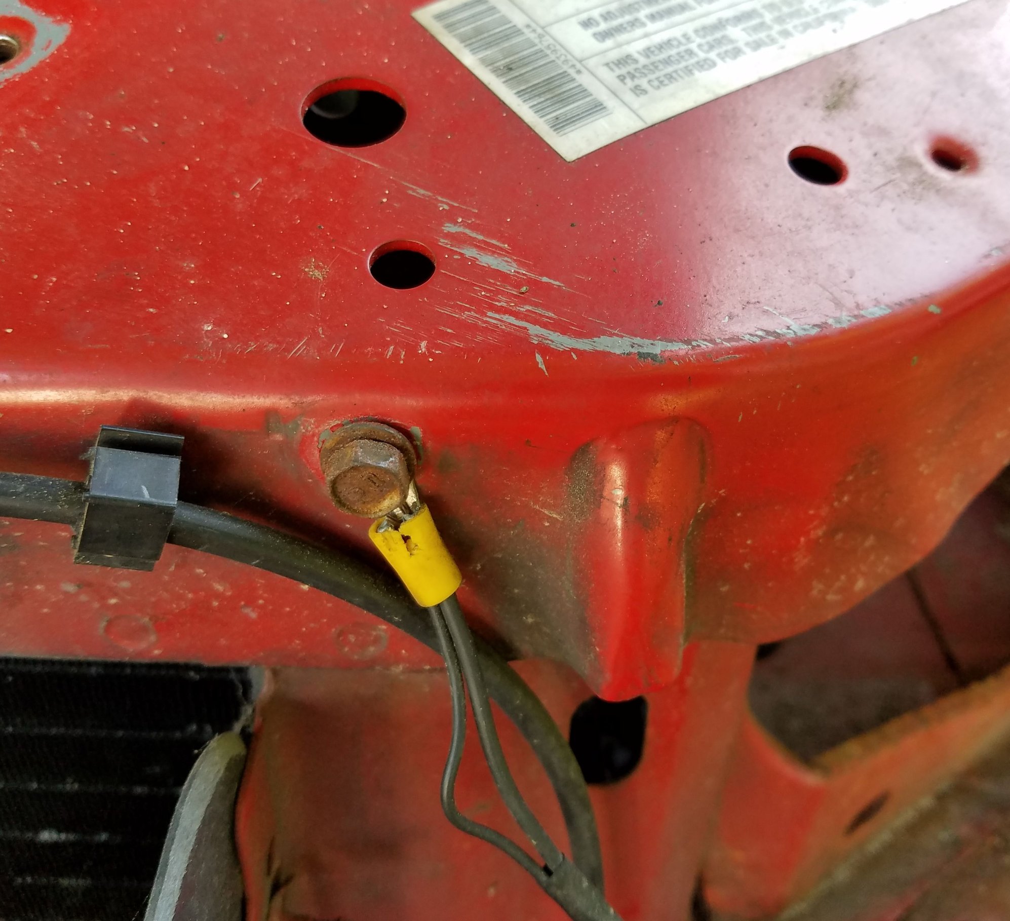

Hey man, I'm having the same issue! Just the High Beam Out light when all.my bulbs in my headlights work. Is it possible to show a picture of the gorund wire that was faulty?

Here it is, right next to the drivers side headlight. My headlight is already out but no need to remove anything to fix the connection.

I have a question before I fix mine: when redoing the wires in a crimp terminal, can they be put together in one terminal hole and be crimped together? Instead of being separate in their own terminal? Cause my factory terminal has the 2 split terminal for each wire

Works fine if you wrap them together and use one crimp, the electricity will flow through the two wires into the single connector to the bolt same as the original one did.

Okay so I can put them both into a single terminal connector, great. Do I have to twist the wires together or just simply insert them both into the connector, then crimp it?

Either way should work, I stripped about 1/2 inch of the insulation off of both wires and twisted the ends together to hold it better when I put the connector on. That keeps the small wire from coming loose later if your crimp isn't tight enough.
