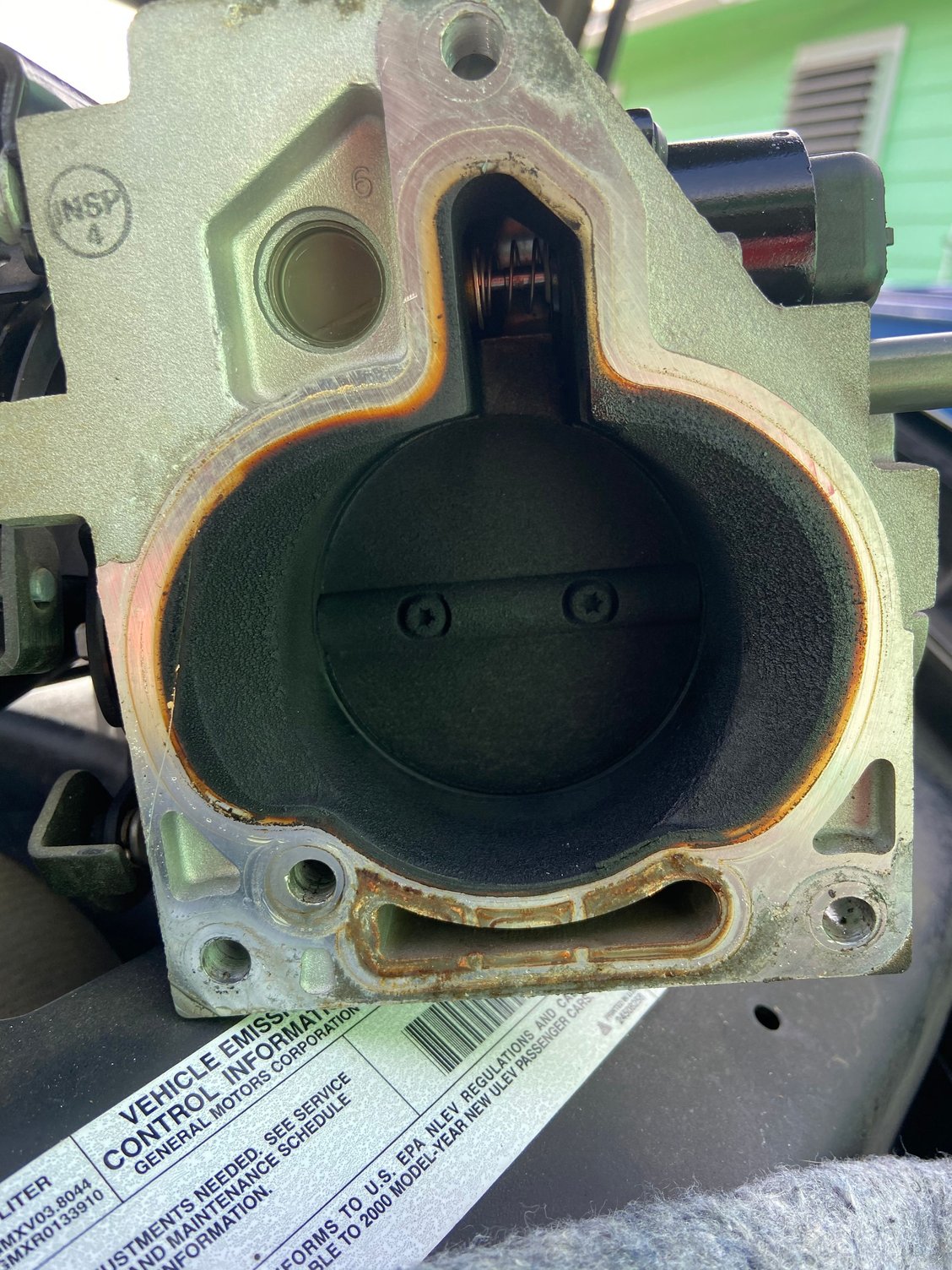

searched for Vac leaks...starting fluid along all lines and junctions...engine died when I sprayed the throttle body gasket. Used a cigarette to see if it sucked the smoke in...sure enough!

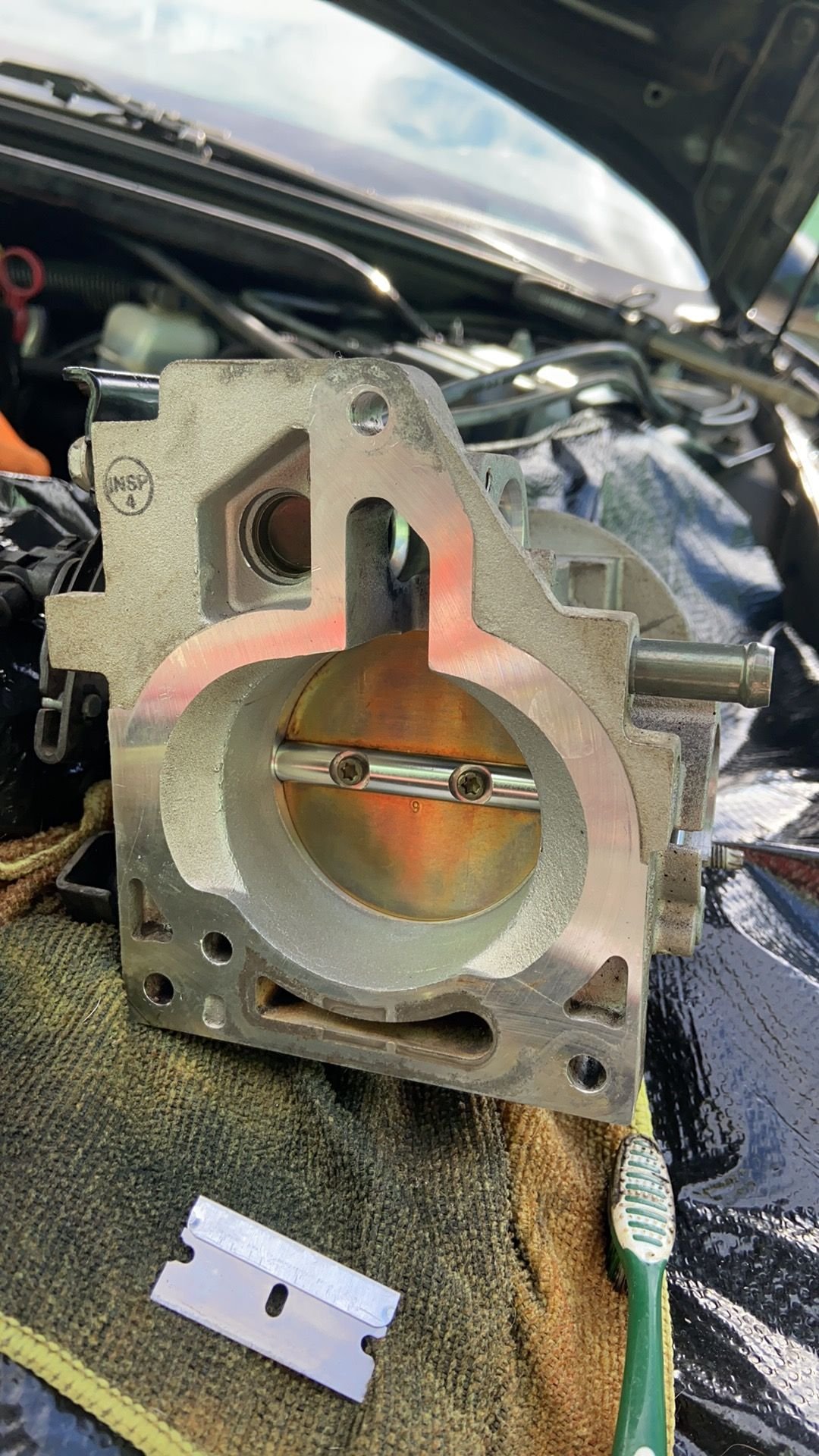

pulled the throttle body, cleaned it and replaced the gasket. No more dying at low speeds, no more coughing. So happy because I was going after the catalytic converter next! BUT still dies at idle when warm.

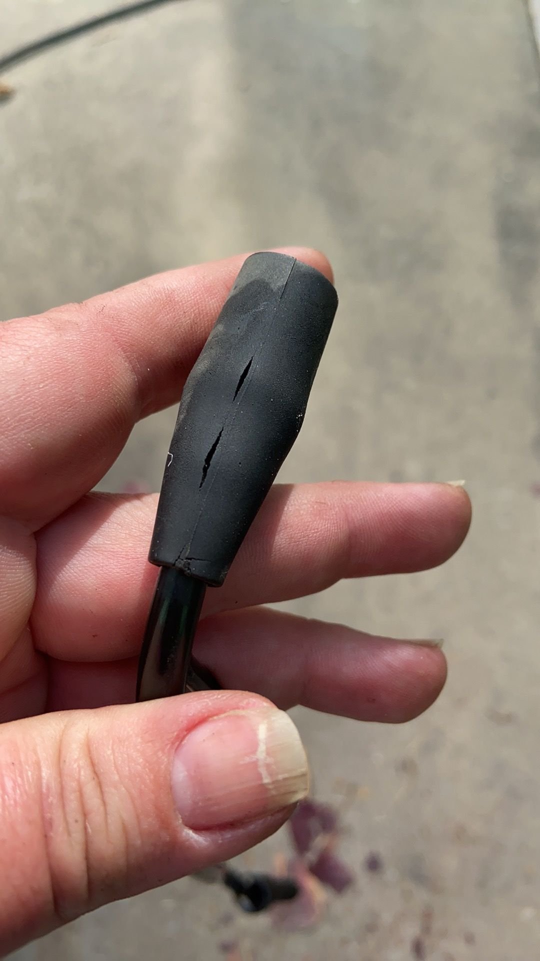

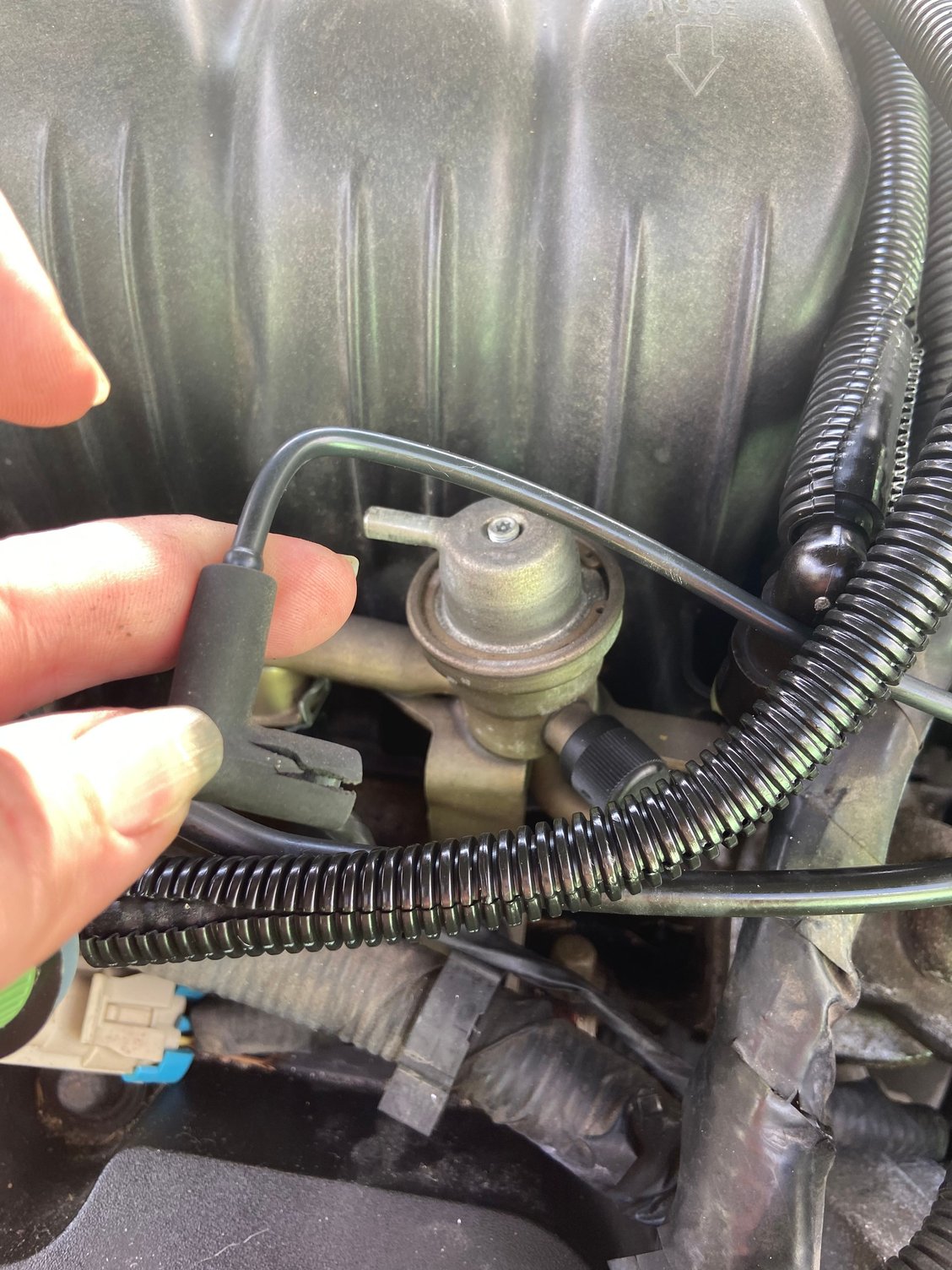

found another vac leak on the harness from fuel regulator to evap emi- all rubber has small cracks- replaced a vac boot and taped the other pieces real good until the part comes in next week. She does purr like a kitten now...still dies at idle when warm.

Take a razor to remove any deposits for a good seal with the new gasket.
89k on this throttle body. Just a rag, throttle body cleaner, and a toothbrush for the tight spots. Make sure you remove all the sensors first!
Old gasket.
Would have never seen this if I hadn’t removed it for the throttle body gasket. It was on the under side. $6 for a new vac line elbow in a multi pack until the new harness comes in.
Same part- harness- electrical taped that bad boy until the new one comes in...

Okay just a hunch but try to find the Fuel pressure regulator, they will go bad and cause an explosion under the hood.
This causes engine explosions, with prior signs of rough idle, misfires, stalling, backfires, and poor gas mileage. You definitely want to replace this before it fails and causes an explosion (which usually destroys the upper intake manifold,, fuel rail, and possible some injectors in the N/A engine.
