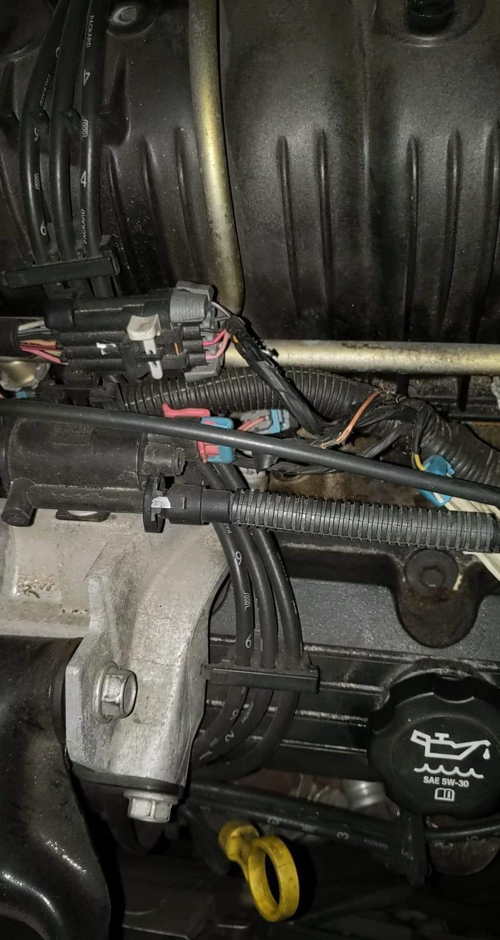

So I've had some issues with the P0443 code for the past two months or so. As I went in to check the purge vent valve, I was greeted with the fine inconvenience attached to the post. I've already located a nest full of straw and gasket material in the engine before, but I cleaned it out and didn't worry about it. Anyway, I'm not sure if I should just run wire in between the green wire to reconnect it or to buy a new harness. However, those wires come off of a larger harness. I'm not sure what I should do and if I should even buy a purge vent valve.

If it were me, I would just replace the section of wire. Just insulate it good with some heat shrink and itll be fine.
