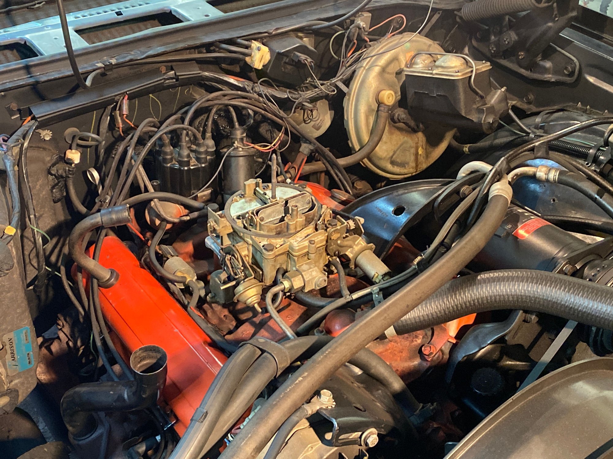

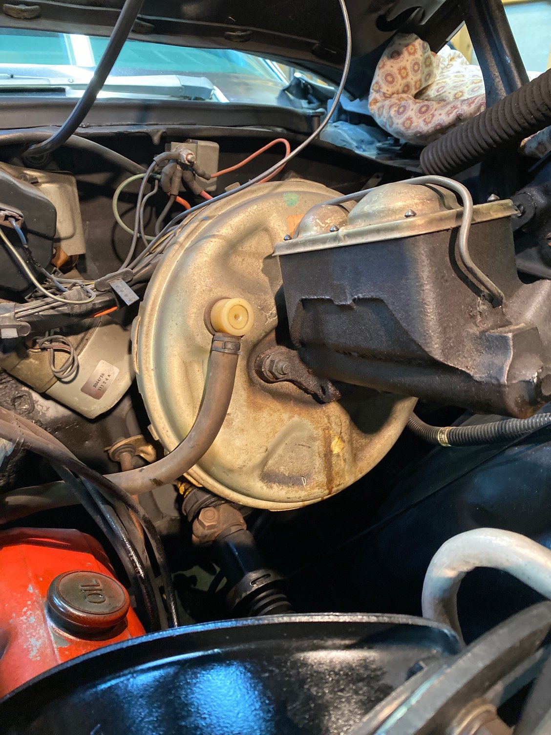

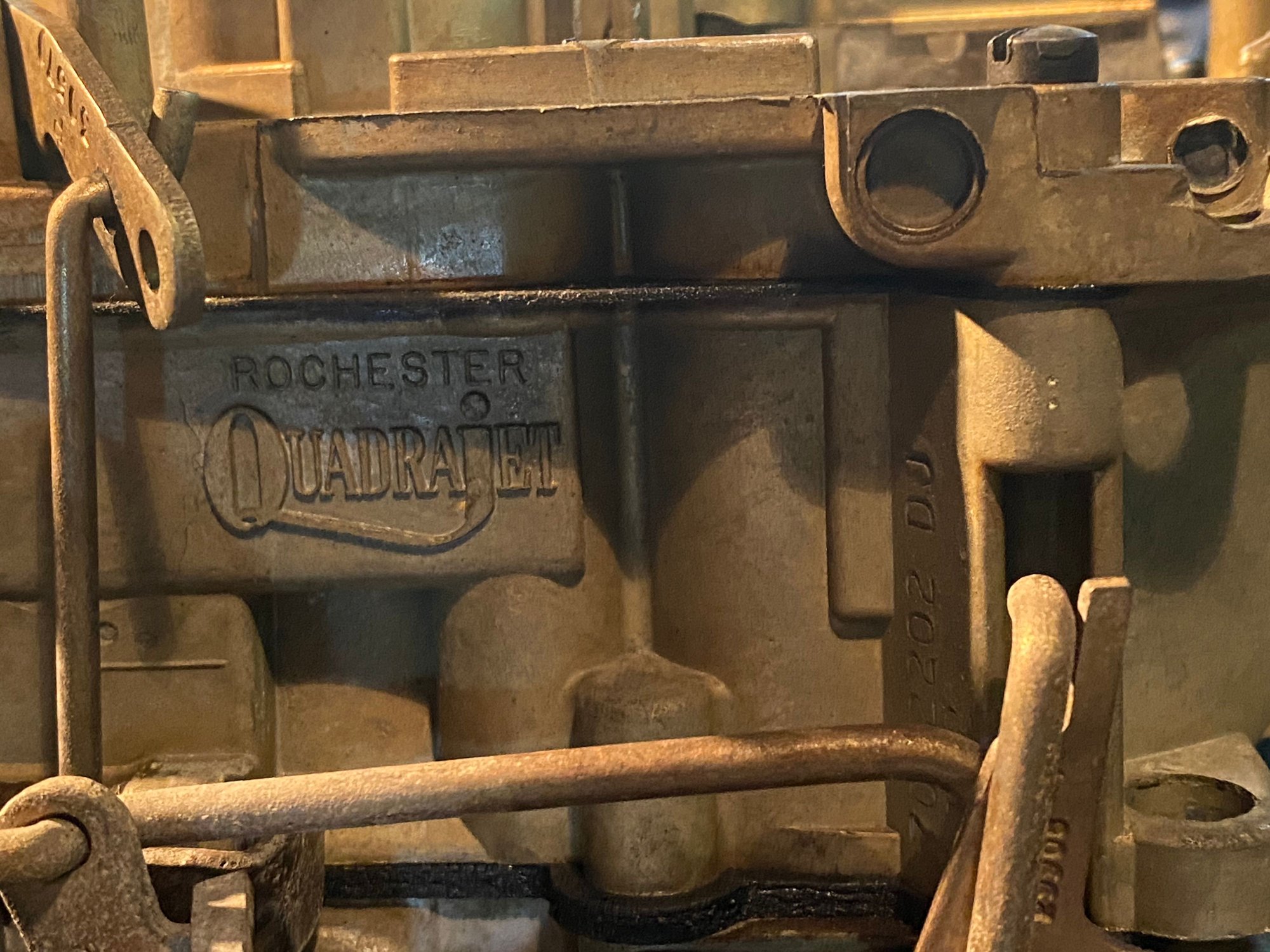

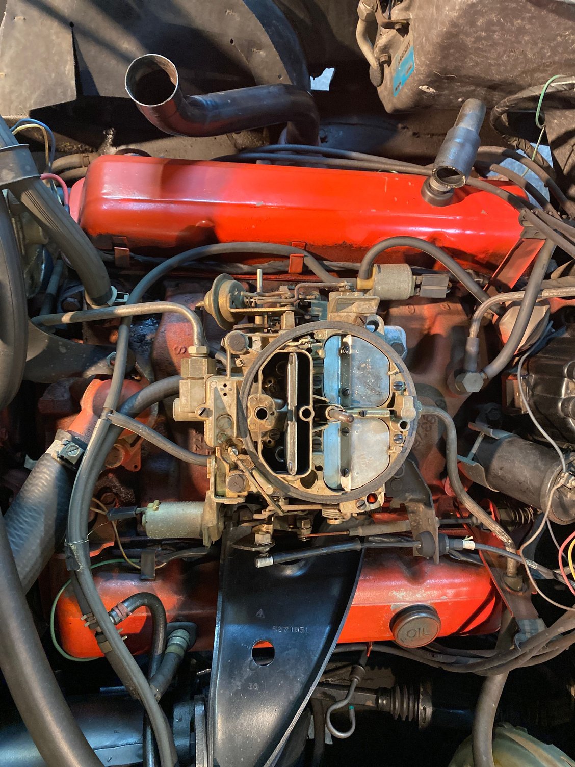

Thanks guys! I’ve attached a photo of the engine block here. I’m relatively new to car mechanical. I know the basics and I’ve dealt with small one and two stroke engines when I ran a lawn care company. I performed regular maintenance on the machines including carb cleaning. I’d be lying if I said I wasn’t a little nervous to disassemble and reassemble the carb for cleaning, any videos or help you could lend. Take a look at the photos as well for more clarification

this is what I believe to be a Rochester quadrajet Carb. I worked on a few and they can be a pain in the .............. Then also put the Carter AFB carbs on these things.
Well I wouldn't take it apart just clean the unit setting there with gumout spray carb cleaner. Then you might want to replace the vacuum lines too There are a couple of Solenoids on the carb that may need to be replaced.
there is plenty of info on adjustments online so you can look that up. Just google it, probably some stuff on youtube too.
I pointed out a few things
Fuel pump

Thanks drivernumber3! I bought some plugs for it at Napa. Just got what they recommend but wasn’t sure is specific brand or type is better. See photo attached. I’m wondering if I should flush the coolant as well based on some foggy color. The reservoir is clear but when I pull the rad cap it looks a little foggy. What do you guys think? Should I flush it? I noticed a brake fluid leak at the master cylinder. I’m thinking the gasket needs to be replaced due to wear. There’s some unwanted travel in the brake pedal that id like to tighten up

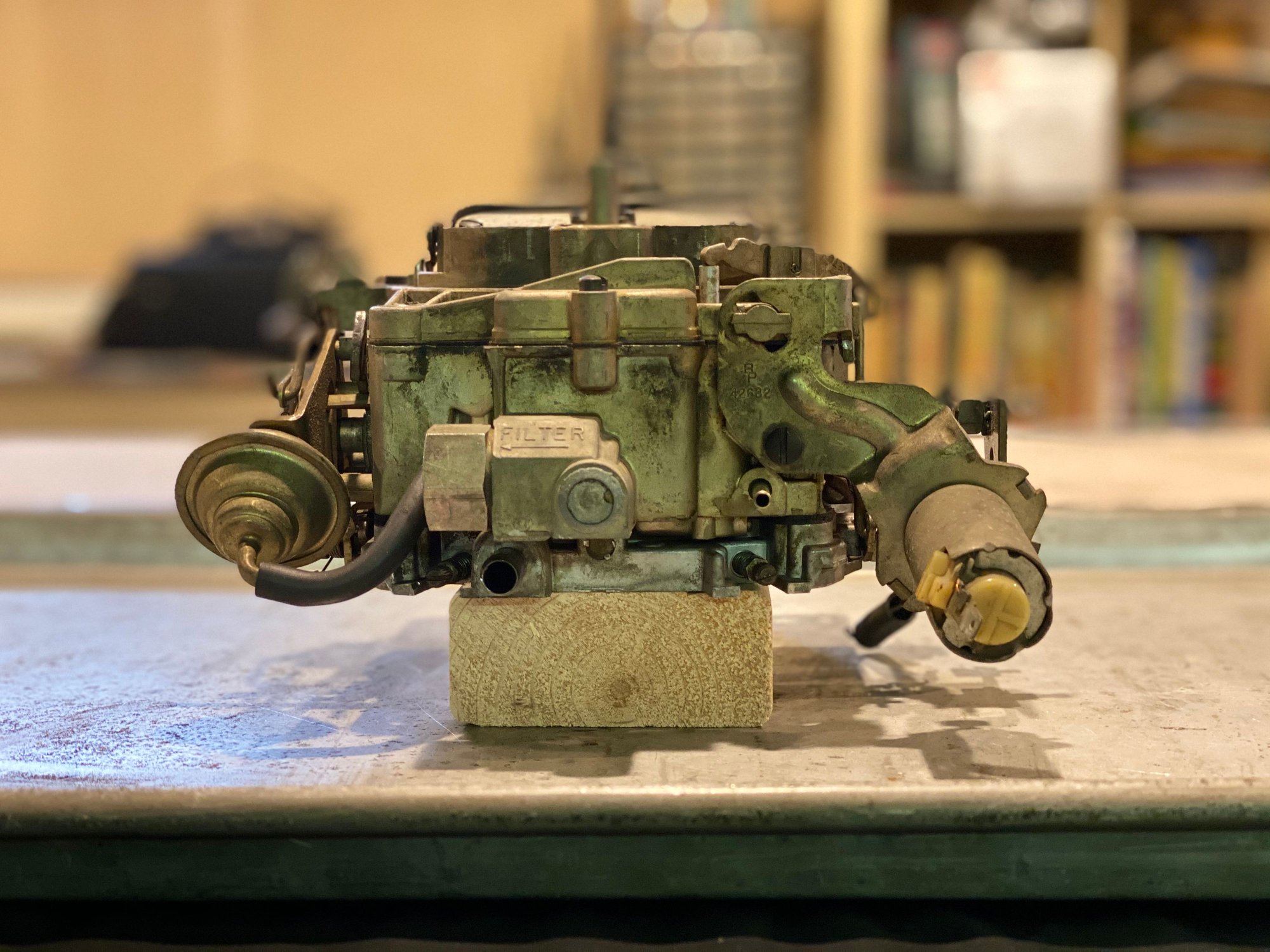

Correct the posts are not factory, for some reason that seems to be the only item that I don’t have for the car. I’ve been looking around for a while and can’t find them anywhere. If anyone knows a parts supplier I’d be very interested. I purchased a rebuild kit for the carb from a part supplier after narrowing down that it is a Rochester quadrajet see photos attached. In my cleaning and exploration of the carb it looks like there may be a tear in one of the gaskets which could be a contributing factor. I think I’m going to have to remove and rebuild the carb. I’ve found a couple videos and how-to’s on YouTube. The problem I’m having is the carb that’s on the vehicle seems to be different than the ones in the video. The right angle fuel inlet in the front where the filter is located seems to be a rarity. All of the videos have straight fed fuel lines running north and south when facing the front of the vehicle as opposed to east west which is what I have. Any advice on the rebuild?
also the plugs that I mentioned in the last post were a bit longer than the ones that were in the car originally, any reason for concern there?
Identifier numbers are described on a Quadrajet website but the dj is not explained. The service manual and VIN comparison show the carb as a 4-bbl RPO L48. I have not been able to rectify those numbers either

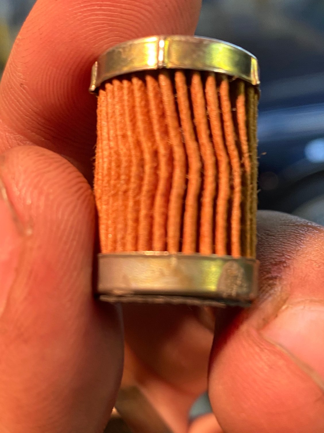

This is the fuel filter I pulled out, looked pretty clean. Spayed with compressed air and reinstalled.

The filters usually fill with a fuel sludge that you may not get with compressed air?

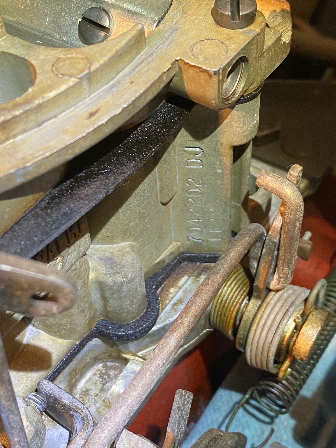

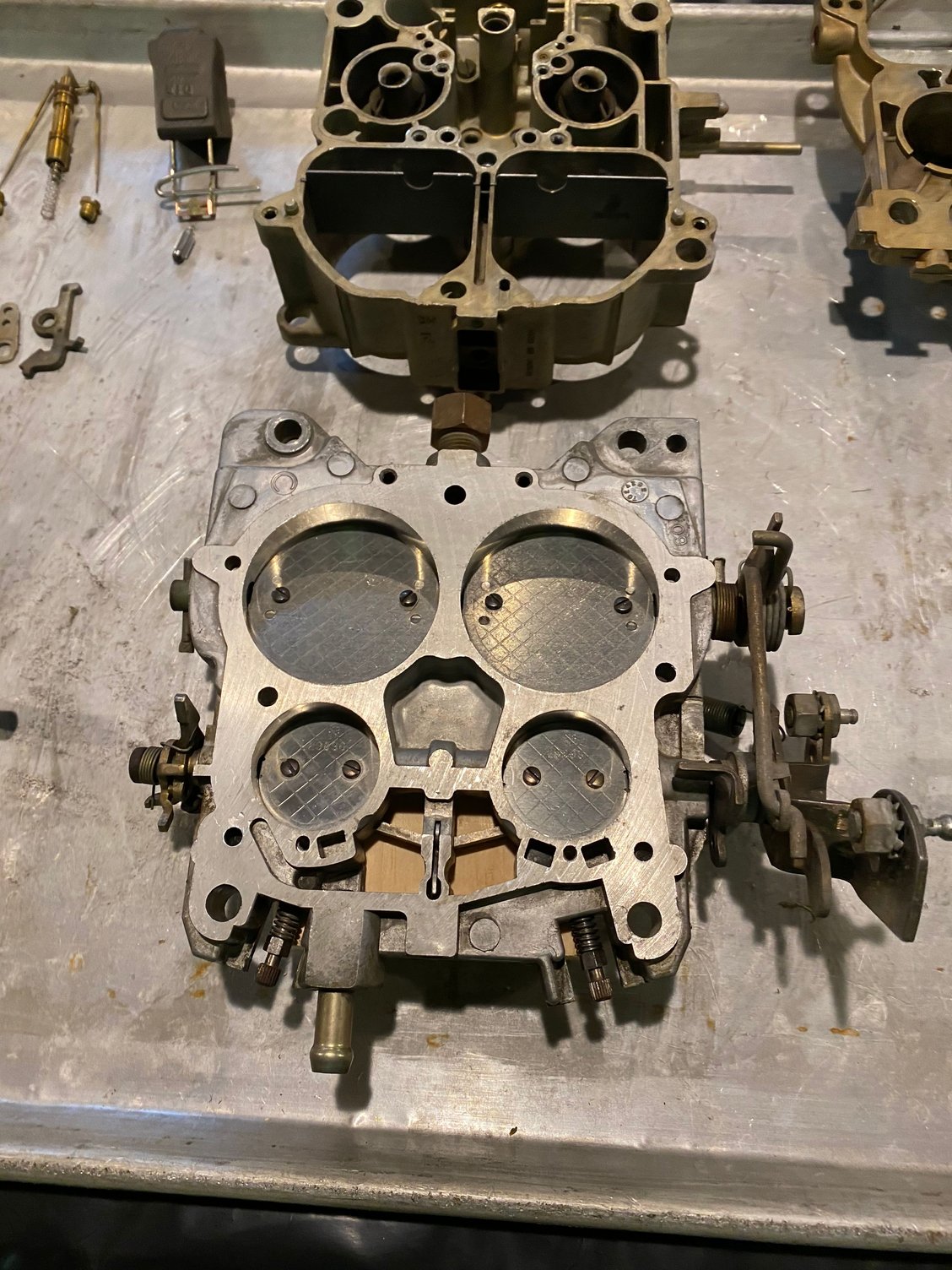

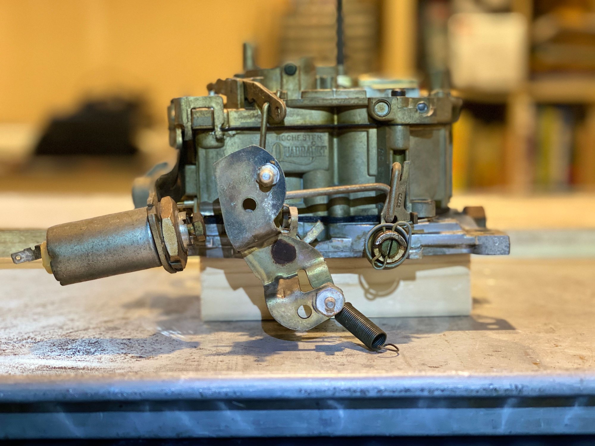

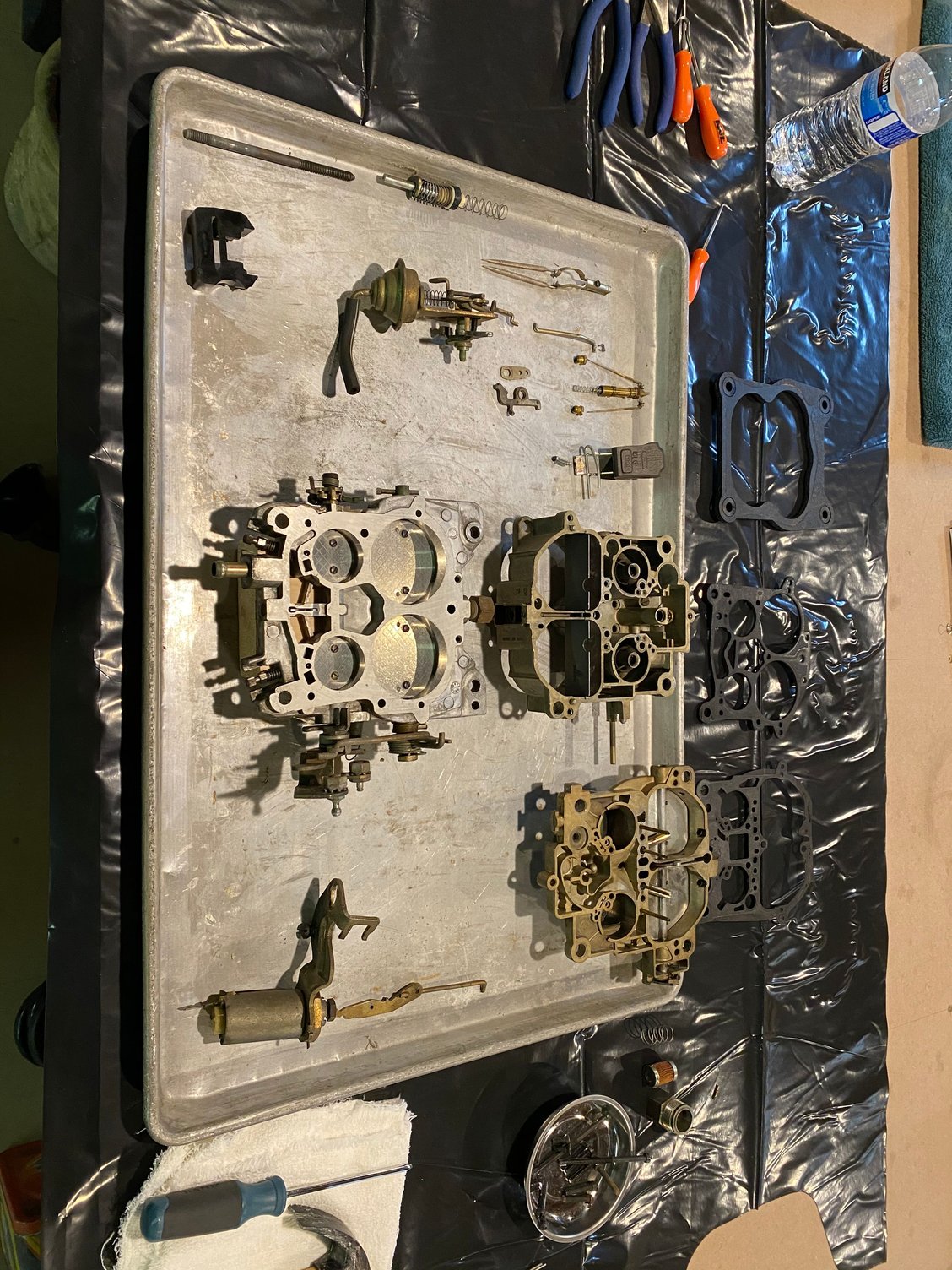

For those interested, I pulled the carb and disassembled it down in the basement with the help of some tutorials and manuals. The inside wasn’t dirty at all, some carbon buildup on the walls. All is in perfect condition except for one gasket. See photo attached. I’m not convinced this was the problem however, I feel like it may have been ripped in a previous attempt to clean the carb while it was on the vehicle, the filter is getting replaced, the vacuum pump works perfectly and the solenoid has free travel. I’m thinking that the tuning part of the carb once’s it’s back on the vehicle will make more of a difference than anything. Plenty of photos attached for those interested
