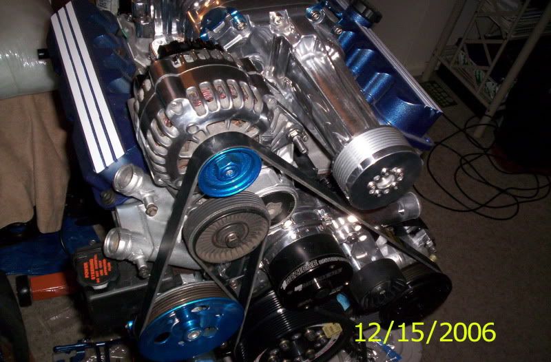

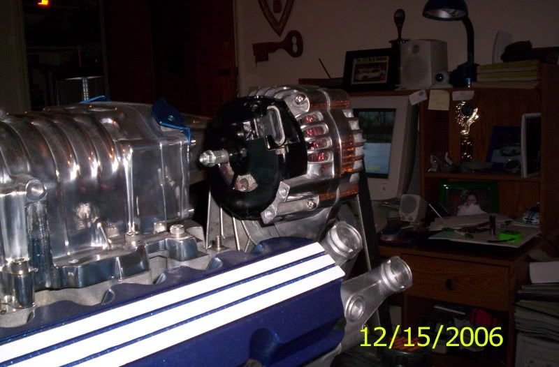

Here are some pics of my alternator during my last stages of assembly (some stuff is still kinda dirty because I was making sure certain stuff fit ok before I did my final assembly):
As you can tell, I didn't do inside the vent holes- and it looks bad without that done. I simply ran out of time- and didn't have any more small buff left that would polish inside there (I was only a couple weeks from the swap, and would've had to order more buffs- and I had enough else going on at the time anyways with school and finals and such). I hadn't done any hand buffing on the parts and such yet- hence why nothing really looks super shiny (plus I think the camera kills some of the effect that you get in person from polished parts anyways).
