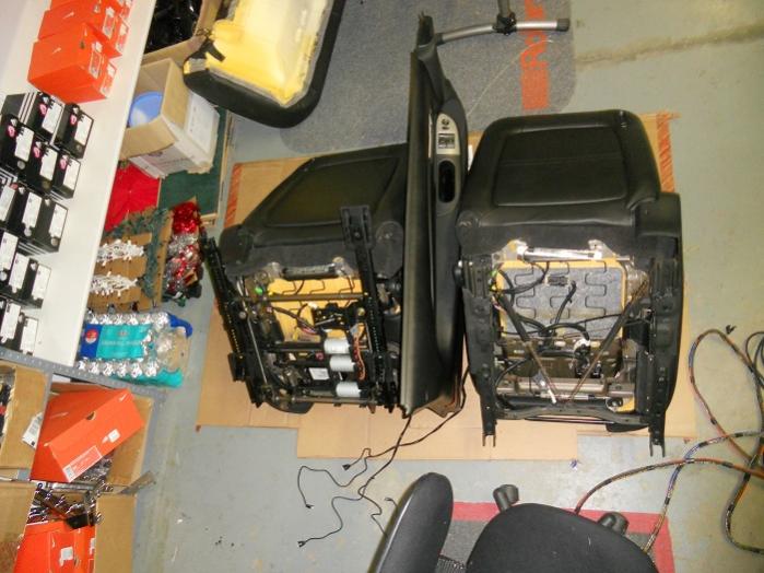

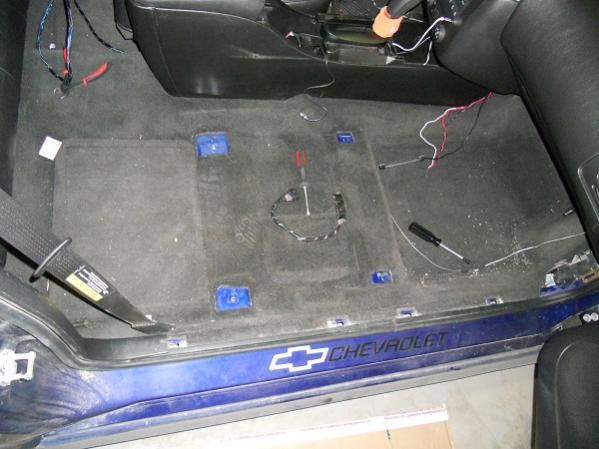

Here are the seats. . . . keep in mind they're more pictures of the LED's but it gives you an idea . . . .
~~~~to remove~~~~
move seat as far forward as possible, take the headrests off, take the bolts out of the rear of the tracks, tilt seat up and unplug the connectors, now tilt seat as far forward as possible and lift up . . . warning--they're heavy LOL :p
"hooks" on the front support . . . .
How to run a power wire to back without going through hole in firewall-dscn0796-1.jpg
bottom of seat . . . .
How to run a power wire to back without going through hole in firewall-dscn0806-1.jpg
both seat bottoms
How to run a power wire to back without going through hole in firewall-dscn0874-1.jpg
car with seats removed
How to run a power wire to back without going through hole in firewall-dscn0807-1.jpg
