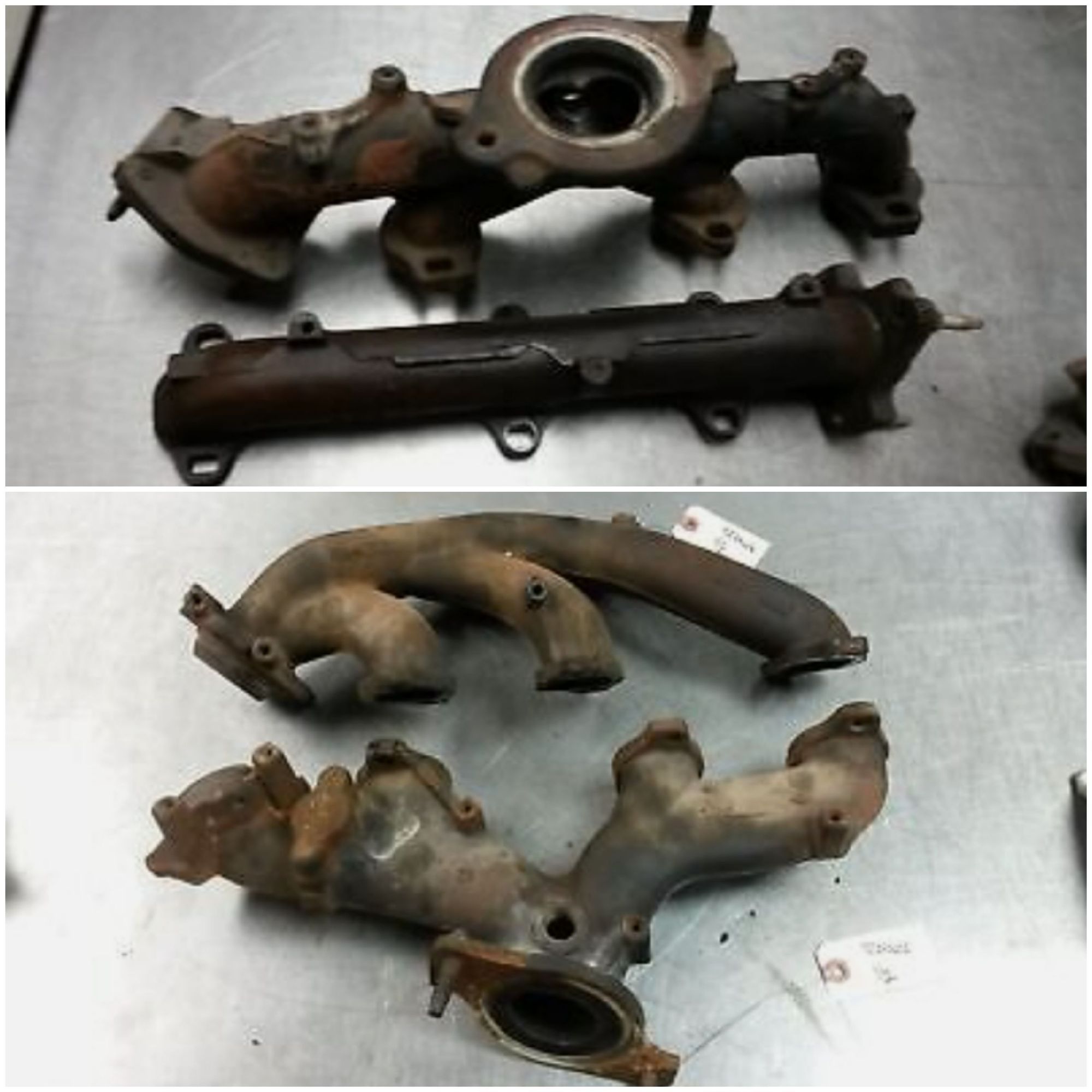

What about using 3500 manifolds instead?
Pulling up pictures on Google, the manifold I found for a 3400 v6 looks horrendous for NA performance (maybe OK as a turbo log). But the stock 3500 manifolds are much closer to a shorty header, at least up front.
Being the same engine family, perhaps at least they'd bolt up? It also looks like manifolds interchange between 3500 and 3900, so these should easily support 230+ crank hp.

Just curious, have you seen dyno results on 3400 PEMs? That front manifold looks horrendous if the picture I found was accurate.
I'm just not familiar at all with the 60* engines and would hate to lead the OP to waste money on something that doesn't have verifiable gains.
