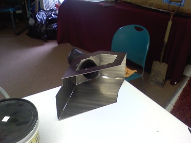

Alright so i finally got some progress done with the new CAI. I bought a K&N cone filter (3.5") and some ply reinforced silicone tubing ( about a foot) and made the intake shield at work. The air is being used from the fenderwell and the stock location. I got a little creative with the top and made a cut out for some tinted plexiglass so you can see the cone. I think it came out pretty sick.
In the first three pics you can see relief cuts that were made so i could bend the sides up. They were welded shut and i painted the "inside" black for my final product. Also the first three pics do not show the plexiglass but the last 2 do. The last 2 pics also show the tubing ply silicone tube i used, the tube actually goes past all the ribs in the elbow and stops right before the sensor.
As fas as gains go? Well its not a rocket ship but you feel the throttle response, you can hear the air getting sucked into the motor, idles smoother, and the engine sounds better imo. Plus it looks pretty cool. I'll probably take more pics later if anyone's interested, plus i got the whole step by step i took to get this far, but for now, Enjoy!
