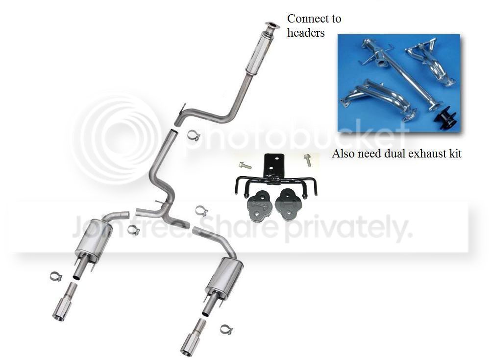

MY SET-UP:
This is what I am saving money up for. I want the Pacesetter armor coated, but if my budget is as bad as it is now, I might be forced to go with the normal black paint which is also good, but just that it wont outlast the armor coat one. Here is what I created with Paint using the previous images, I hope I got the setup right:
I have a coupon that could get me the exhaust for $490 shipped now, but I do not have enough, so I will probably have to wait till next time. But I bet you could negogiate the pricing if you want to. As for the conversion kit I couldn't find the kit sell for over $30 shipped(it isn't much of a kit to begin with, lol) Then for headers, as said I haven't settled for anything yet. But with this set-up do you think I could get some power out of the engine? I think the whole system would end up costing from $900-$1100 shipped. I also believe that the exhaust system also works in conjunction with air intakes or force induction too. so Hopefully I got all my information right. Now my only problem other than money is: I don't even know how to use a wrench yet. Hopefully I learn soon, as in after my college semester ends so I could finally focus. Please Comment, and tell me if I am right or wrong with the set-up or if I mistaken any information. Now thanks for reading

I also have an 02 with the 3.4. I would go with the headers because you get rid of the factory downpipe with the restrictive u-bend. I was going to get the zzperformance downpipe with high flow cat but they quit selling that for the 3.4. if you can find a nice downpipe with high flow cat and then go to duals you could save some money and skip the headers. if you can afford it go with headers. now I need to find a place that has the downpipe for the 3.4 cuz I was ready to start that project over the winter.

That's the U-bend. It's a restriction in your exhaust for the oxygen sensor right before the Cat. So NO cat-back exhaust system will replace that.
Here's my honest opinion on your exhaust. You are dealing with the 3.4 engine, which honestly I don't see pushing enough power in and out to need THAT much exhaust. I would get a shop to delete that U-bend (putting a straight pipe with a bung for the oxygen sensor) and then just change the mufflers / split the exhaust if you want duals sticking out the back. If you were doing bigger upgrades to the engine, that will force more air in and out, like porting, intakes, cam, etc. Then I would say getting headers would be beneficial, but on the stock 3.4 I don't think it is.
From the Cat-Back you won't have any restrictions in your car. Changing anything there is just for sounds. The U-bend will restrict, and your stock manifolds / downpipe will restrict when you are pushing more out.

you should take chibi's advice. headers might look cool and all but not worth the money. I am thinking of starting with this http://www.summitracing.com/parts/MPE-23433/ and going from there to duals just for a better sound. the replacement cat is a bolt in and has no u-bend but a shop would be cheaper if you just want to cut the u-bend out and go from there

I see so I was Wrong, The cat back connects to the ubend after the headers. I did hear that I might not need that big of piping, but with that size, you might get better sounds and if I decide to go more into the engine I might be able to gain from it, but otherwise I might Lose some torque. I have an air intake, but I'm now research about a bigger throttle body, as that might work well with the exhaust. My friend wanted me to just buy a 2.5" y-pipe and some 2.5" piping and get 2 glass packs or cheapo mufflers and make it a done deal, but I didn't know should I invest money into that, as some say glass pack on anything below a V8 is bad, but I seen countless 4 cylinders do it. Thanks for telling me about the U-bend, I am highly considering it.

Yea But I wasn't sure how much a ubend would cost. I heard it is about the same pricing though. Like 300-400. I'm not sure, but if it is around that I might as well get the headers for the case that I might continue work on it. It all depends on the money and job now though. That Cat looks good though, lol it seems I want to try everything on the car, but not enough money.

Headers will have the manifolds, down to a downpipe and connect to the cat-back. That will delete the U-bend but Headers IMO is a waste of money on the 3.4 without serious modifying and tuning.
2.5" is the biggest I would go. Don't think bigger pipes = better sounds... It's sadly not true on our cars.
I somewhat agree with your friend that if you want the duals, just put a Y-pipe and throw a muffler on, along with the U-Bend delete and call it a day. A U-bend delete should not cost anywhere near $300. All you need to do is put something like this on:
https://www.zzperformance.com/grand_...=504&catid=110
Any shop should be able to make one of those, or even just weld that one up for you while doing the rest of your exhaust.

Yes, just try some local mom/pop style muffler shops. I had my u bend and resonator deleted for $50. Being saddled with a 3.4 is going to keep the performance upgrades to a minimum, but good mpg is a nice thing too!!
Oh, deleting the resonator only makes it slightly louder at idle with the stock muffler. And that is standing outside the vehicle. Inside, I couldn't tell the difference.

I also have a 3400 in my car. Obviously, the performance upgrades are not the best on the market, but the ones that are there are useful and pretty nice. I have the Pacesetter ceramic headers and u-bend, cat, and resonator delete, followed by a 2.5" magnaflow exhaust. I love the way it sound ( to me at least ) and the power increase is noticeable. I would go with the set-up you have planned out. Go to a muffler shop that is good. the exhaust from the downpipe back was total of 200 dollars for everything ( piping, welding, gaskets, and installation ).
