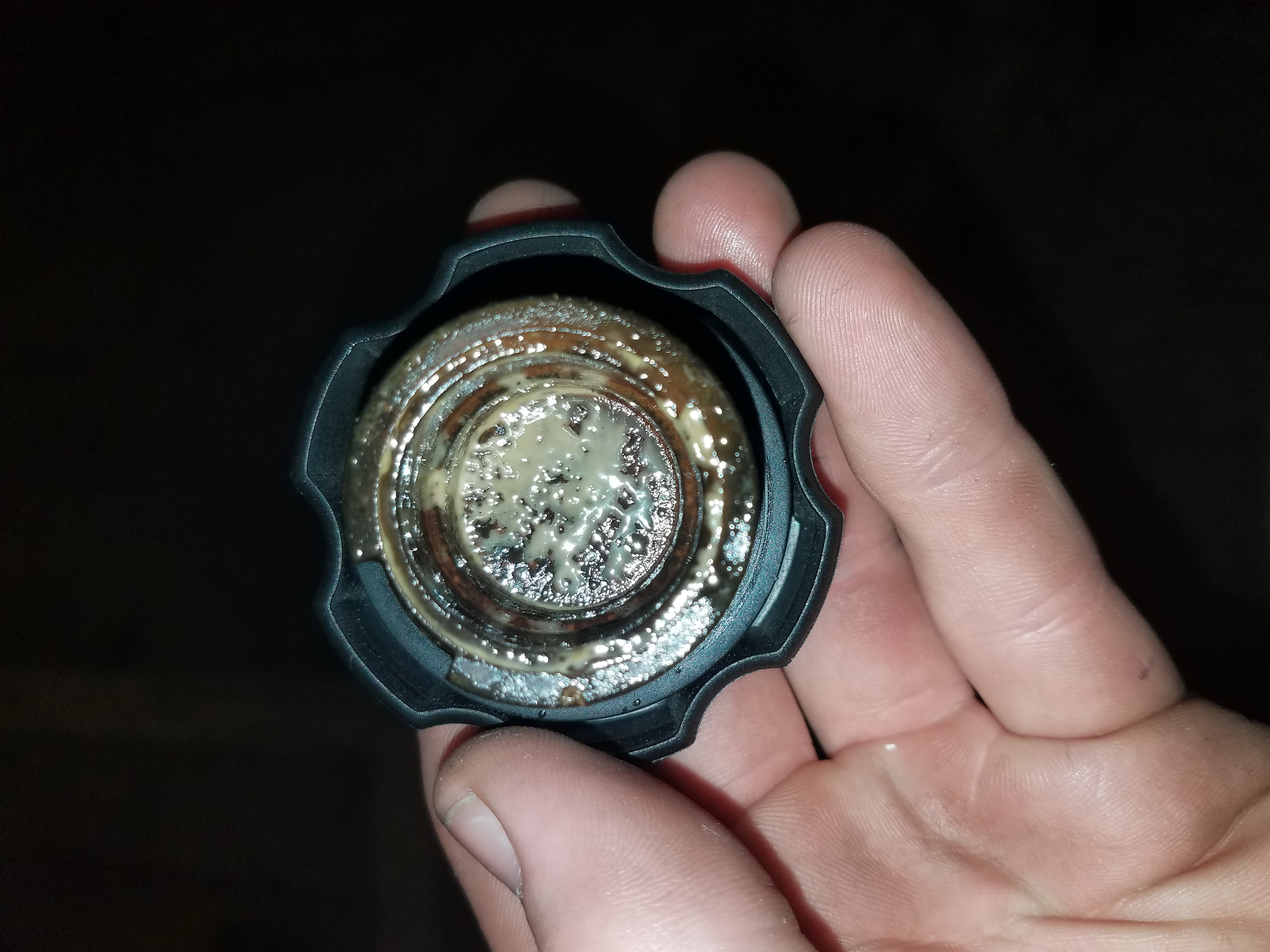

I preemptively bought a gasket set just incase. So I have that covered. Here's a pic of the inside of my oil cap. Can you tell what it is based on this?

Definitely oil and coolant mixture. 3800s don't usually have head gaskets go, but that doesn't mean they don't. I don't know what year GM started with better gaskets (metal lower intake manifold) but everything does have a life and the car is now 12-14 years old.
Let's hope it's the LIM gaskets! Easy to replace, cheap, not heads! How long has it been like this? You could test from hydro carbons in the cooling system.
Edit: what hoses did you replace? When you're doing this, it'd be a good idea to replace any hoses attached to the throttle body and the heater core. Might as well since you've got room while you're in there as well as getting that water pump done. I'd also have a quick look at your power steering pump since you're right there. Check for leaks at the reservoir and repair as needed. I know how money can be tight, but it will save you time and headache getting extra 'little' things done.

Thanks for all the advice. I'll get all those parts just because why not. It's been Ike this for a few weeks bit I've only driven it once since it went wonky on me and that was to test the radiator.
