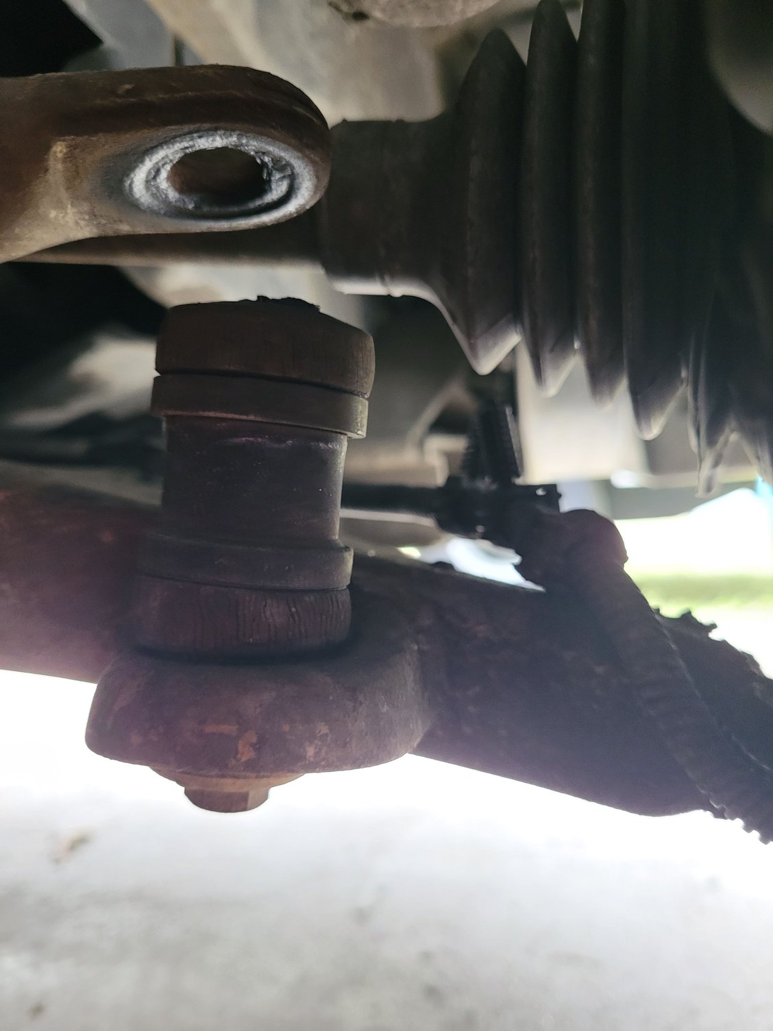

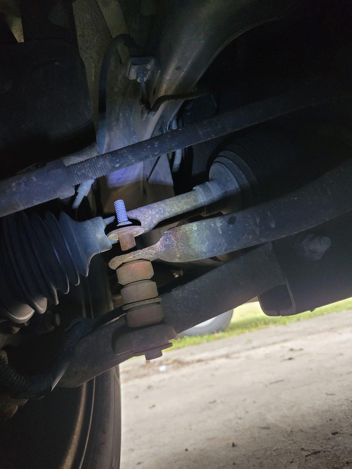

My girlfriend said the oil needed to be changed bad and I just didn't care. I only intended to drive it on weekends until she wrecked her civic. I did the change and started to walk around to see why it skates. Found a broken sway bar bushings and the other was just amusing to observe. After replacing the bushings front wheel bearings, and 3 new tires, it drives like a different car and my moral is going up.
