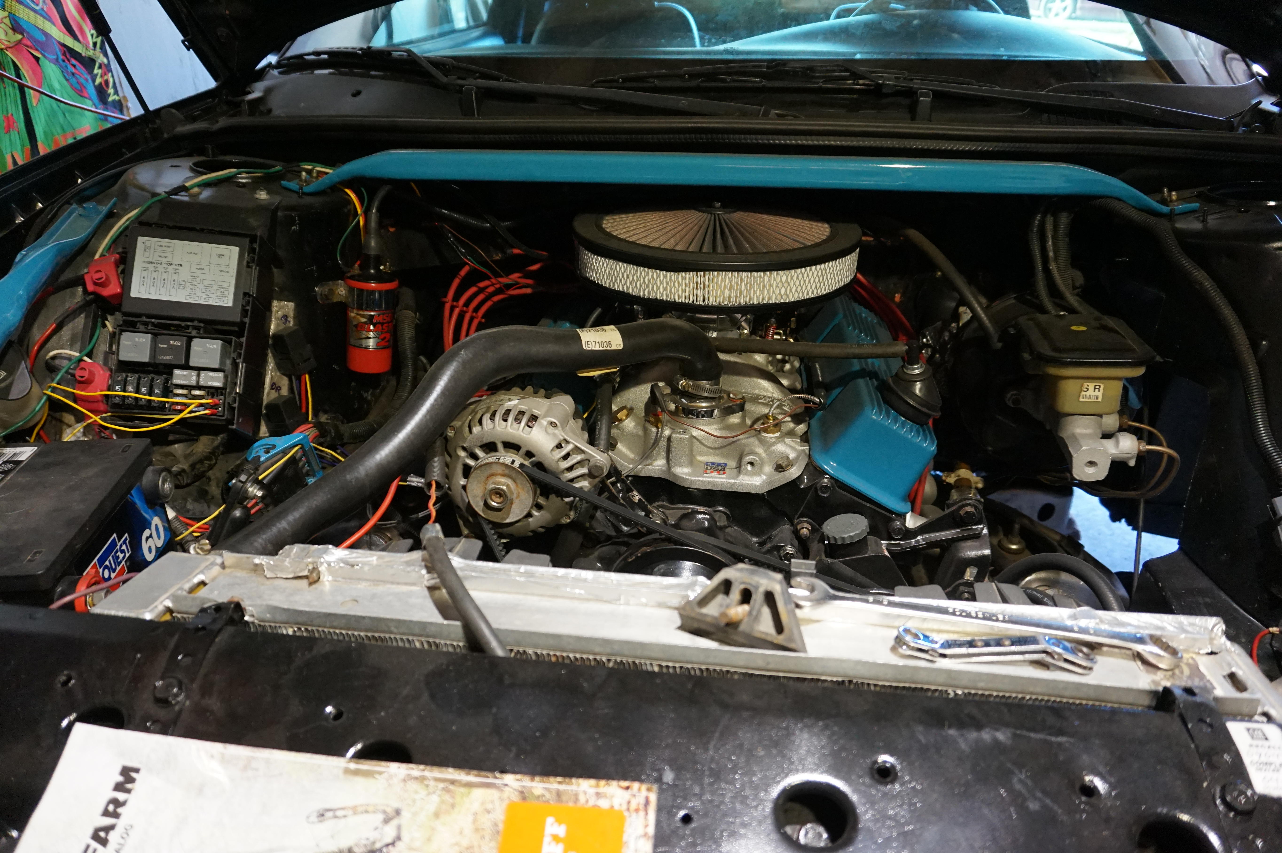

Long story short. Made a rwd car and I'm trying to connect an aftermarket electric speedometer sensor into my 2002 ss . The factory wiring is a yellow and a purple wire, neither being a power. Both of the wires go into PCM and come out of it a single wire to dash I believe. The new sensor has 3 1 power, 1 ground and 1 signal. Would I just bypass and go right too dash or ?

Chassis is a 87 G-body striped down painted, new suspension, eibach drop springs,all new bushings, fuel and brakes lines, 16 gallon cell under trunk where spare was, 2 speed push start powerglide, 3.42 lock right posi in stock 10 bolt , Bassett racing wheels, 409 Cid SBC, 3 inch exhaust with nascar style exhaust tips. The body was a challenge, I made my own firewall, floor tunnel, had to relocate the brake booster because it wouldn't clear the valve cover build my own steering shaft modify the body to fit frame. Engine install was quite a treat to fit under wipers. Air filter even needed to be modified to fit. Still fighting electrical issues need to get tires and probaly a cage to finish the Nascar theme. Took it on a few test drives. ton's of power .

OK, here's what I found...In the engine controls schematic it shows the A/T ISS (4T65E) having an "A" wire and a "B" wire. The "A" wire is black (AT/ISS sensor High), PCM connector 63 will be Red/Black at connector. The "B" wire is dark green (vehicle speed output)(AT/ISS sensor low), PCM connector pin 55 will be red/black at connector
PCM connector pin 64 (yellow) for VSS High.
PCM connector pin 65 (purple) for VSS Low.
I believe your third wire may be unused like you said, intended for a different application.
