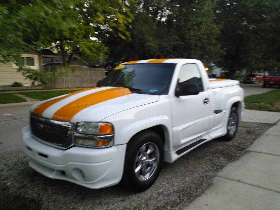

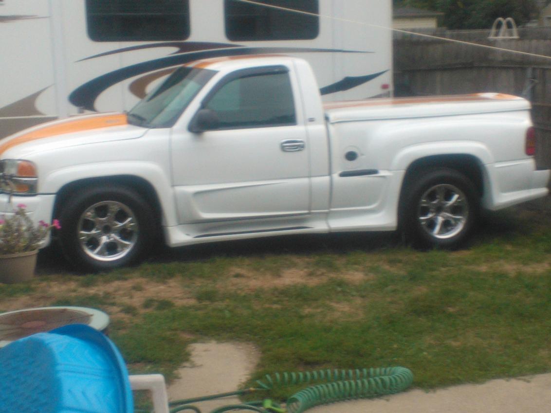

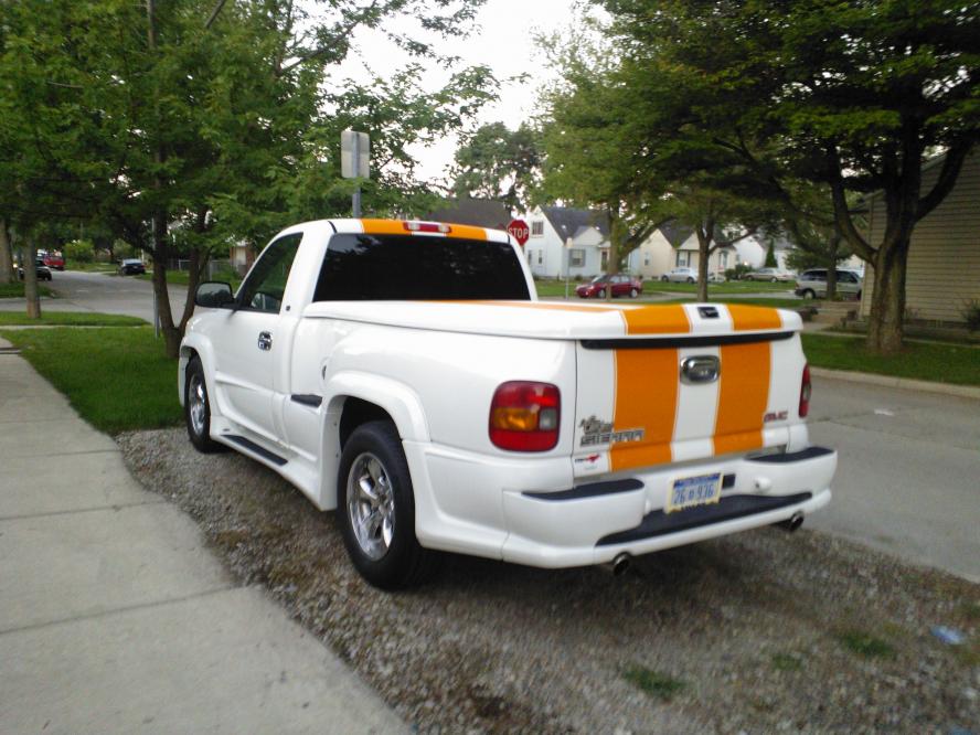

Heres a cpl Refresher Pics Jerry... The first 2 pics were before I did the additions of Tint and vent shields...the 3rd one in the backyard
shows it with the new additions.
