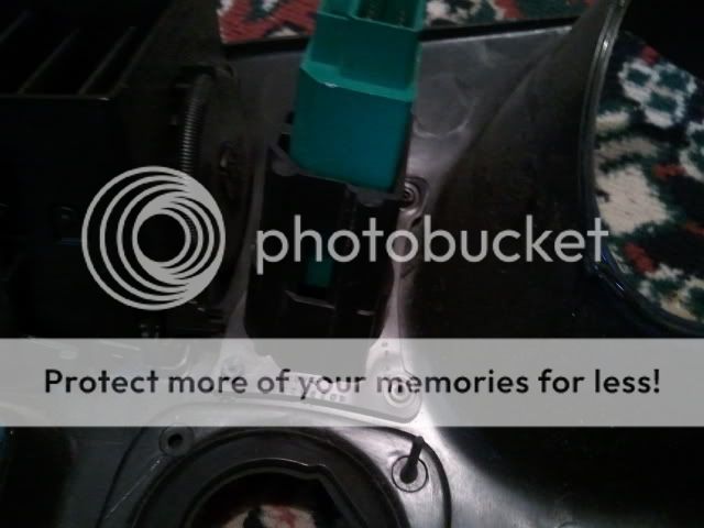

I got a question about one of your vids on YouTube. The one that tells you how to remove your dashboard.
My question is, I want to replace my emergency hazard button, just the button its self. I got two dashboards the one in my car (with the un-balanced emergency button) and the one that I got in my basement (with the the balance emergency button).
It would be easier for me just to replace the whole dashboard, but the one in my basement is not in a good of a condition.
Idk, if I need a special tool to remove the signal or just yank it out?
as your looking at the button in the picture there should be a tab on the left, you'll need to release that tab and then pull it out, then replace the button, hope this helps, let me know if you need anything else!
