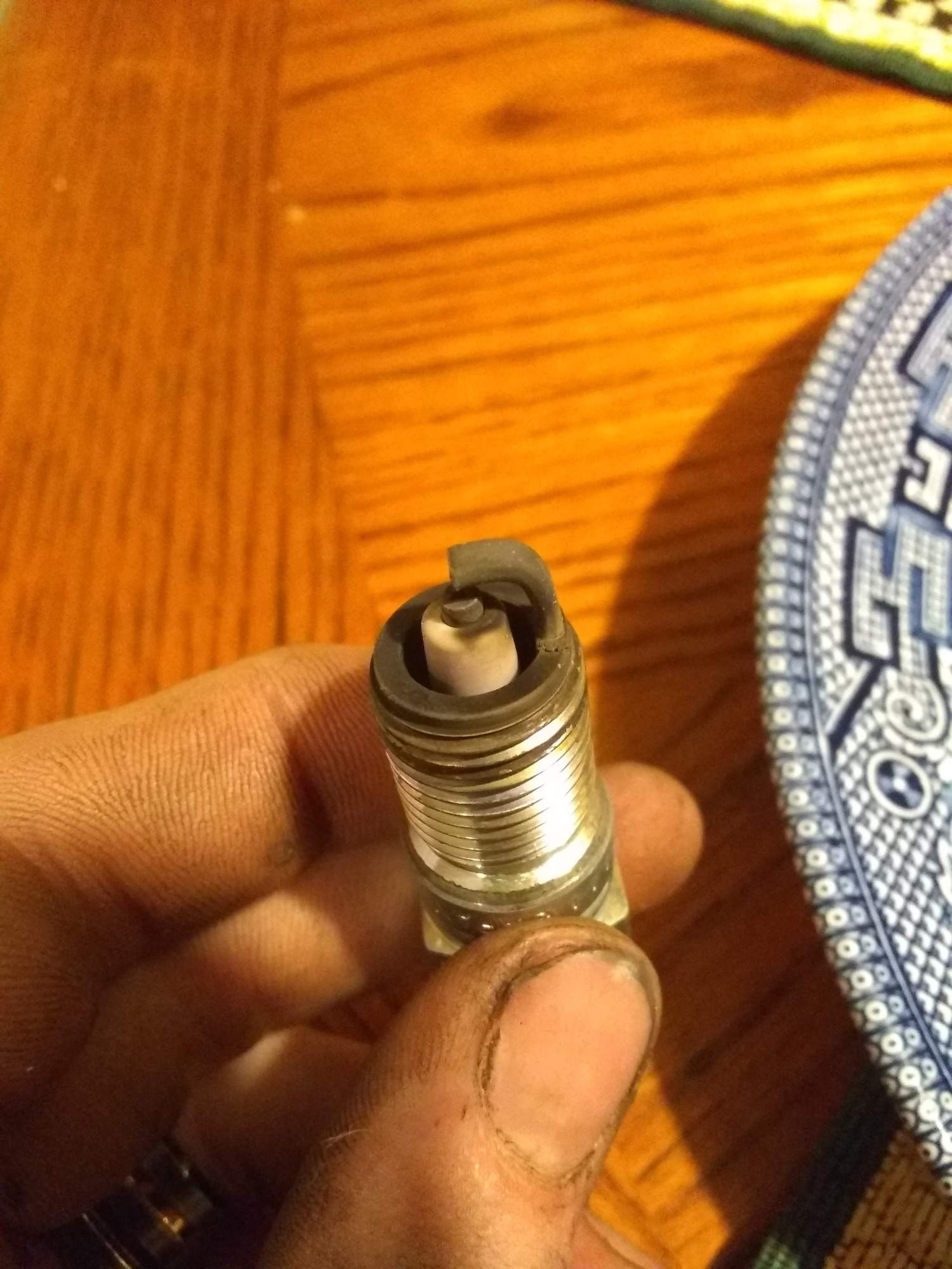

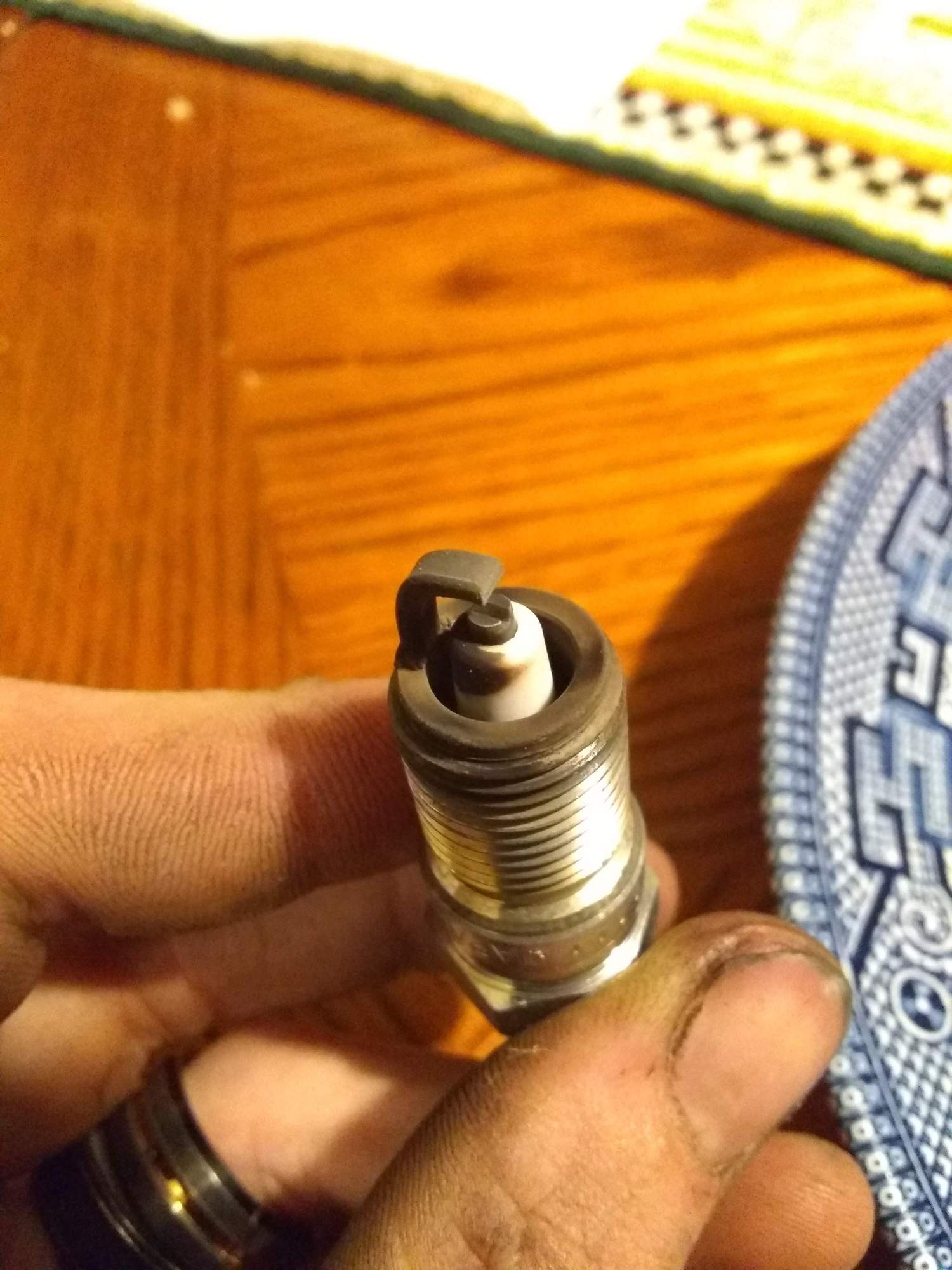

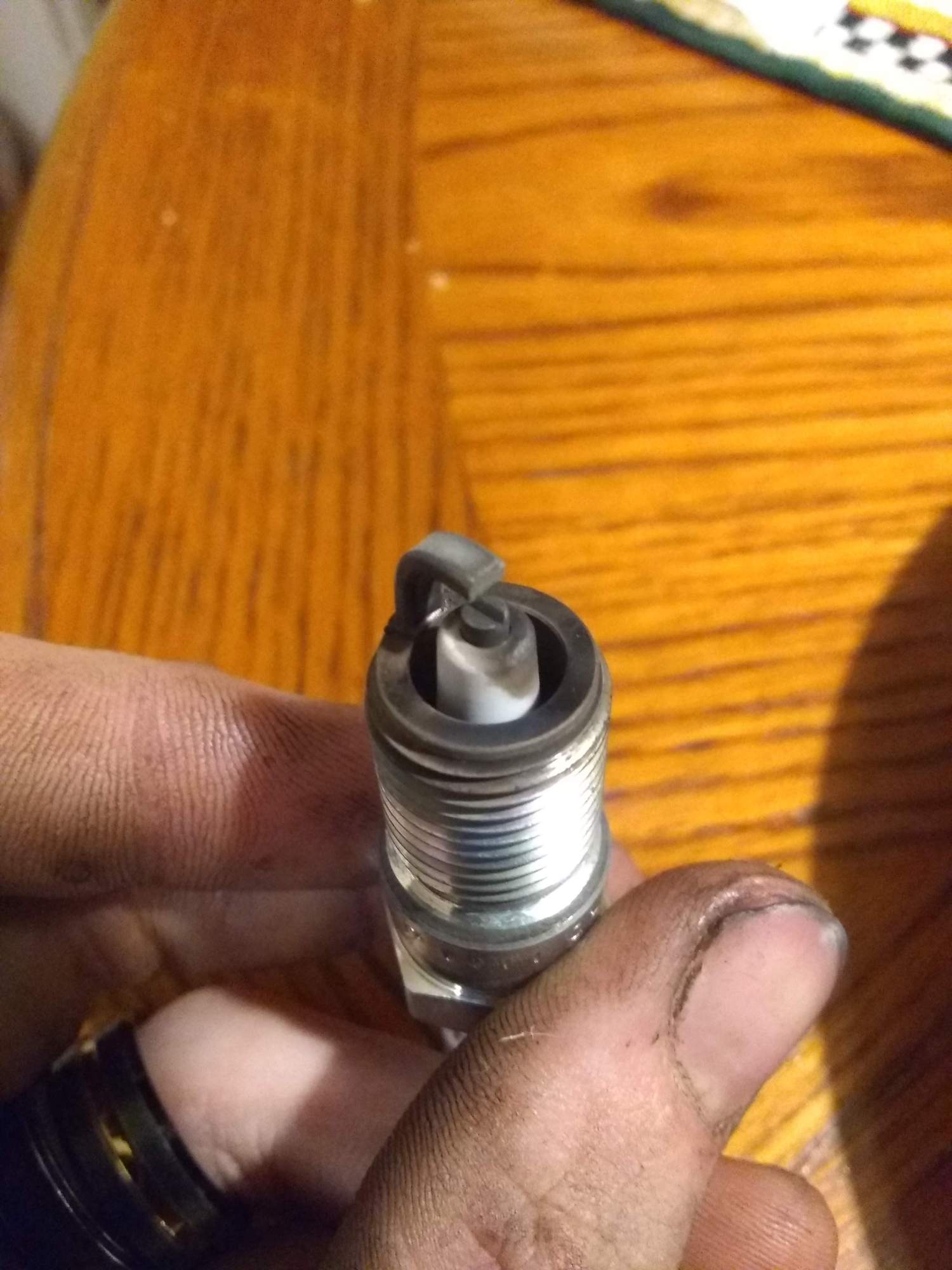

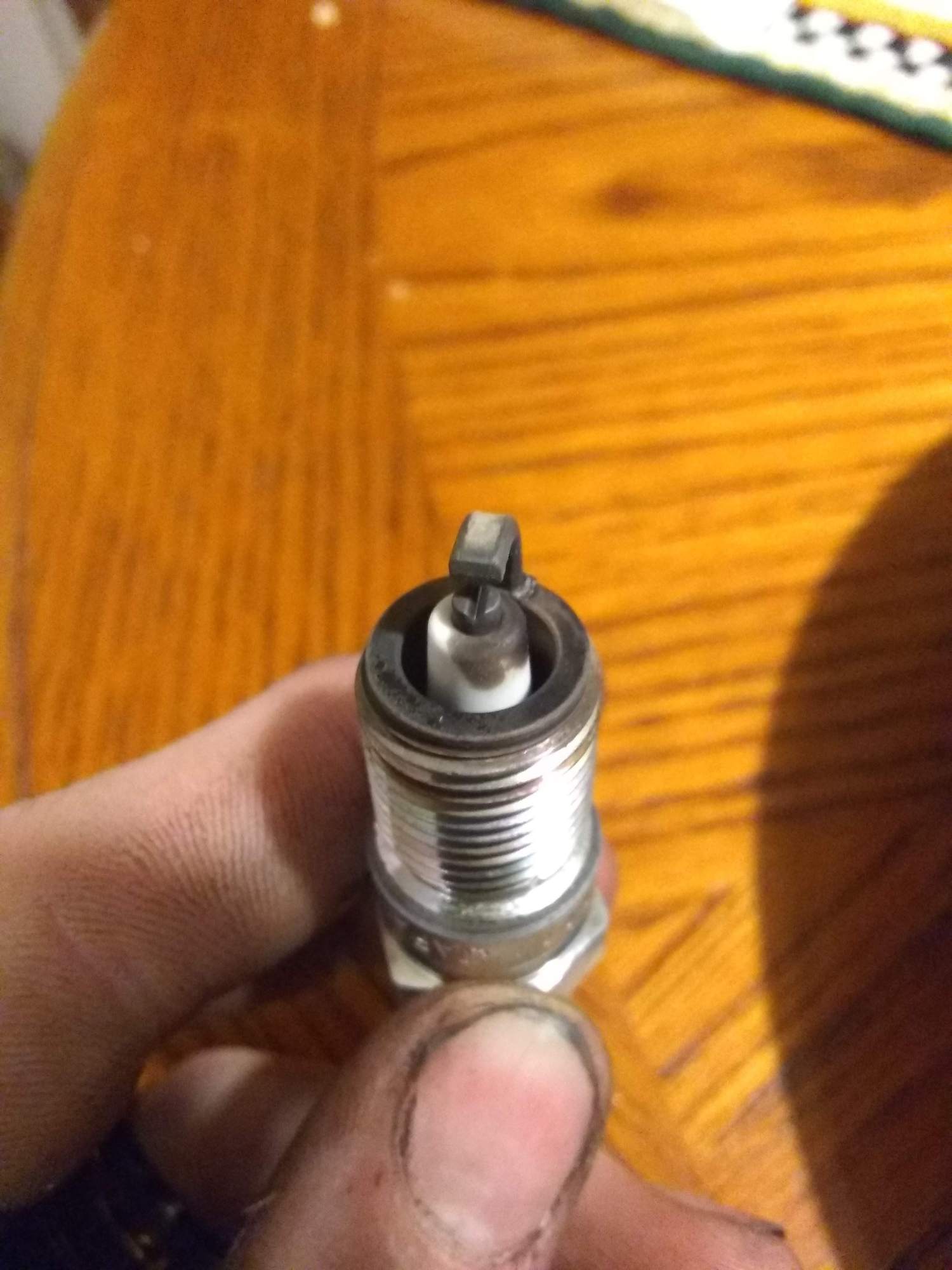

I just changed my spark plugs (NGK TR55's) and oil the other day, and took pictures of all the spark plugs. Lets see if they look off to you.
I'll order them front bank first, then rear.
Old Sep 27, 2019 | 10:07 PM
Posts: 6,471
What gap are those plugs at? That gap on #1 looks like it's well over .100", but maybe it's just an optical illusion.
I also checked the gap before tossing the plugs. They were gapped at ~.057 all within .001 of each other. I used a coin type tool, and I'm not actually sure at which point you take the measurement. Is it the middle of the electrode you take the measurement from, or one of the sides?

Definitely an optical illusion in the picture on those plug gaps, lol!
