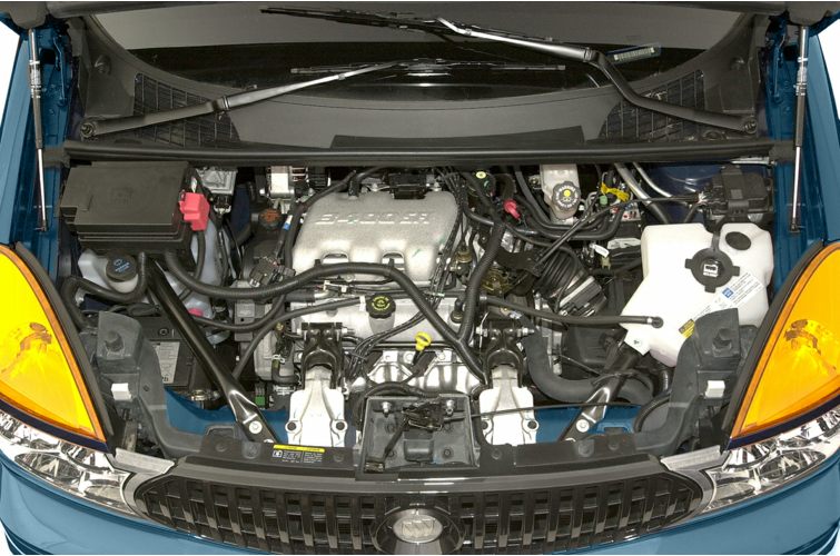

only one like it i have done is one of these... slightly different than a monte but the same...
make sure to bleed the system when your done too
