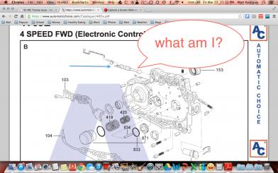

Need a little help on my 2001 MC.
Can anyone tell me what the part is call in my attached pic?

got a bigger picture?
Old Mar 23, 2013 | 08:38 AM
That Pic definately sucks!
Cant see didley squat...
But it does read....
4 speed elctronic control.... with an arrow pointing at it ....
Possibly a shift solenoid...
Old Mar 23, 2013 | 10:10 AM
Looks like the park lock mechanism
Old Mar 23, 2013 | 10:43 AM
Old Mar 23, 2013 | 12:15 PM
It looks like a wallowed out Allen bolt to me...
Looks like it's time to breakout the visegrips!

i went out and bought a slide hammer
Old Mar 23, 2013 | 01:25 PM
volensaeros's Avatar
Joined: Mar 2011
Posts: 16
From: illinois
slide hammer worked easily.
pulled shaft out, greased it works perfectly
now i have to figure out how to get the long shaft with the bend back in.
anyone know?
there seems to be some teeth towards the back in the way. how do i move them?

answered my own question.
its spring loaded, just push shaft into the hole from right side, slightly off center.
all went well except i broke a friggin sensor during this process.
