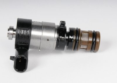

Hopefully it is just a Bad Auto Trans Solenoid..
Good Luck & we look 4ward to your update(s)

It could definitely be a bad shift solenoid, in which case, the labor will be more than the part. LOL. I hope for your sake, whatever it is gets fixed for good, and the dealer you bought it from covers the cost, as they should.
Good Luck!
