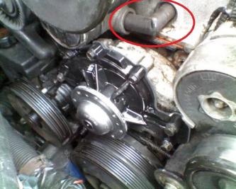

help me what is this part

help me what is this part-image-2013-09-15-1.jpgNeed help what is this part water is coming out of it the botttoms broking

Coolant elbows There is two one upper & one lower here's a link for both...

Old Sep 16, 2013 | 10:10 PM

As I always say....replace with aluminum versions that way this will never hapoen again

I just replaced mine last friday night. It was a fairly easy job, just needed a second set of hands when pulling the tensioner and getting the serpentine on and off, but all in all took about 1 1/2 hours, including the test drive. I unfortunately didn't replace with the aluminum ones listed above in Zjerry's post, and wish I had of, but it gives me a reason to rip everything apart and clean it all up in the future.
