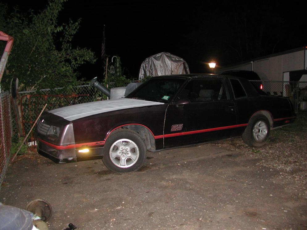

This is my aerocoupe, I have since removed the cowl hood and put a stock one on.

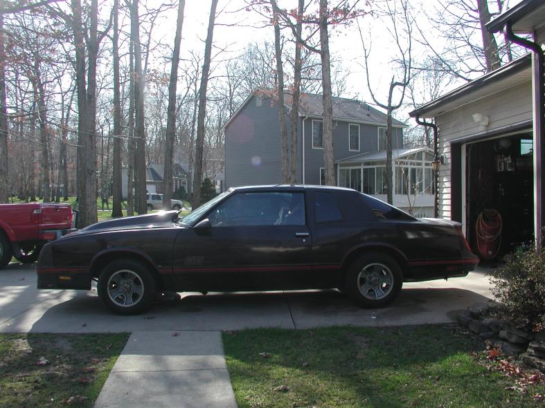

Here is one with the flat hood. Its far from done but eventually we will get there.
