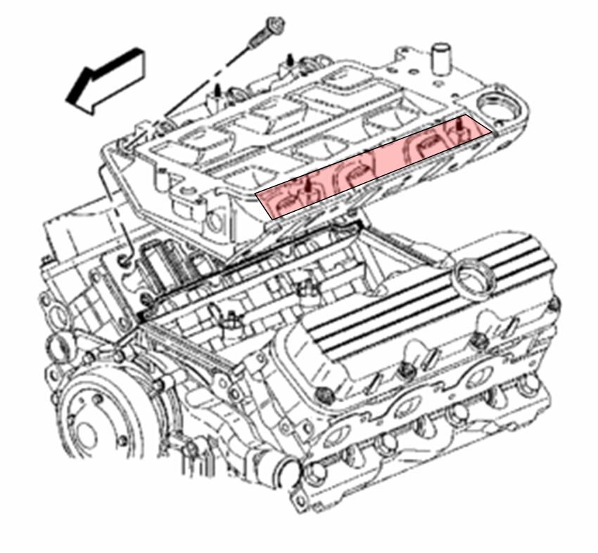

On the forward facing part of the engine, between the head and the upper intake there appeared to be a lot of wet debris and sand and stuff. So if my terminology is correct, this debris was sitting directly on the lower intake. To the touch, it was dirty and dark, possibly oil. See picture below for my awesome MS Paint skills. The red area is where the "wet" areas are.
Is that normally a clean area? It's a recessed area, so any moisture from the road could conceivably end up in this location. With a little more time tomorrow I'm going to clean that area really well then monitor it more closely to see if I'm leaking oil into there. It didn't hardly seem like there was a couple quarts worth of oil in that area, but is it conceivable that that area would be hot enough to burn off that oil over time?

Old Jun 5, 2014 | 10:29 AM
farmerjg's Avatar
Posts: 174
I'm rebumping an old thread, but it's mainly just to put an update on here so if anyone in the future searches for it they'll see it.
My Monte had eventually got to the point where it was consuming about a quart of oil every 3,500 miles. As I was driving down the road this past winter my LIM gaskets decided to completely go. Since I changed those I've now put 5,500 miles on my current oil and the oil mark on the dipstick has not budged even a little. I had no oil in my coolant when I did the change and I never had a leak under the car or out the exhaust. It seems that my LIM's were maybe just leaking by so very slightly that I never noticed the oil, but since I made the change I've been consuming no oil. I'll call that a win.
