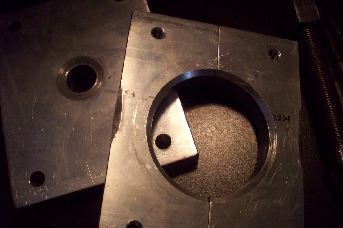

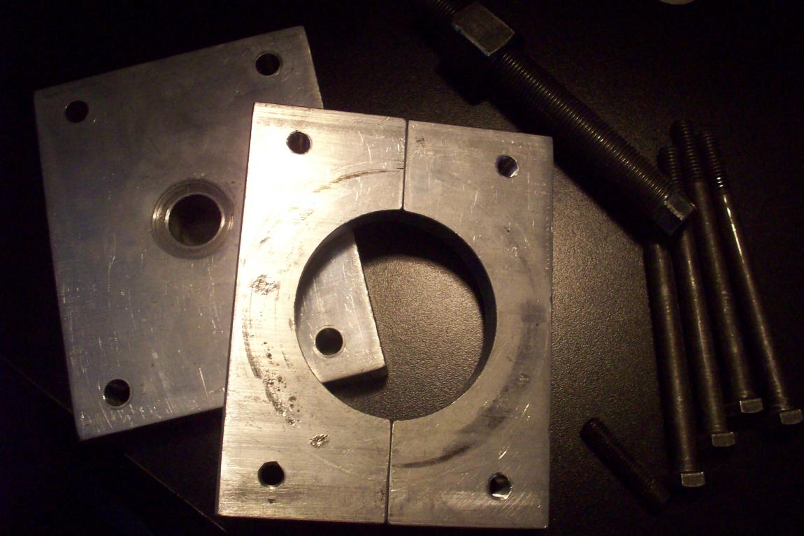

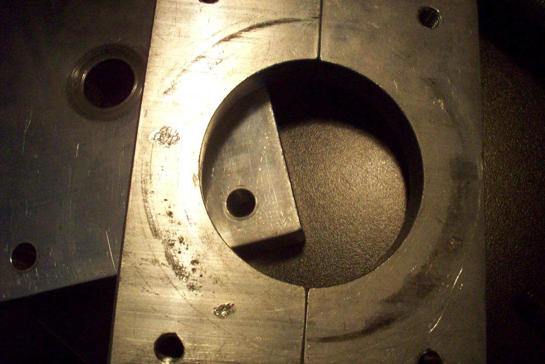

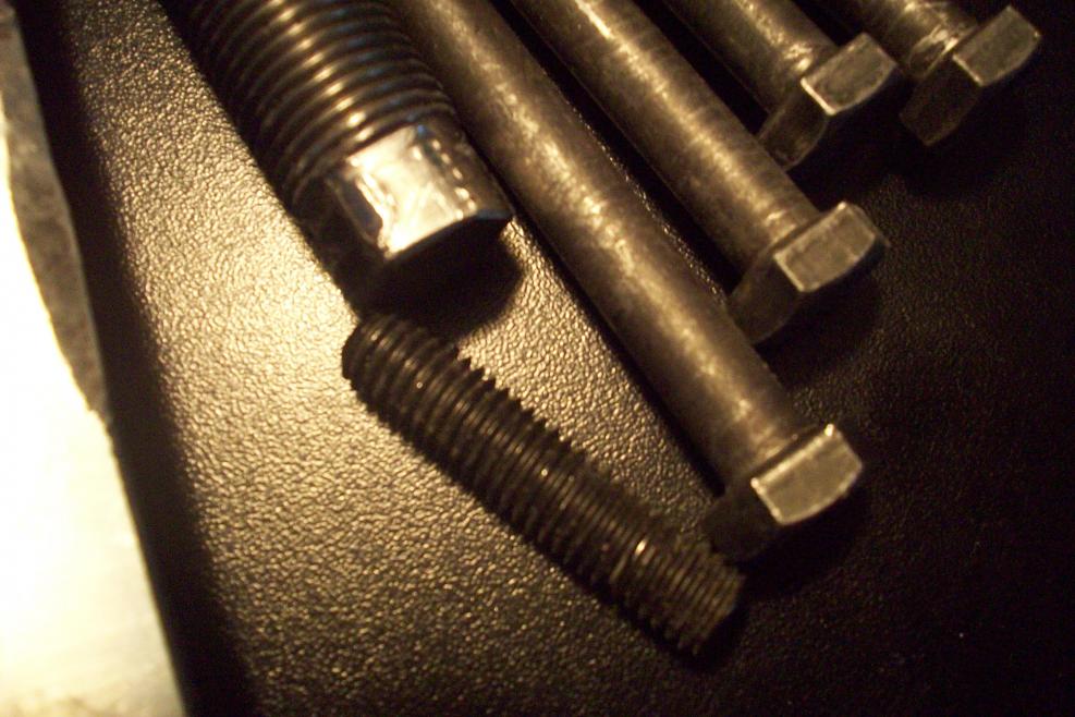

The puller sucked. It is a "new improved design" from 3800 performance. Instead of the C shape, it is a long thick aluminum block, and it bent from the stress of taking the pulley off. It is garbage now, also those studs kept breaking, they included 3. I emailed them asking if they sent me the right one since it didn't look like the one on their site, that's when the guy said it was the improved model. Are they all aluminum or just this one? I thought they were supposed to be steel. Anyway, I will see if it is still in the garage, if so, I will take a pic of it. I am on the lookout for a used scanner/programmer now, I heard a few of the ones that were recommended to me before are no longer made. So maybe an aeroforce gauge?
That sucks to hear, I've never tried theirs before. This is the one I have:
http://www.zzperformance.com/grand_p...=199&catid=111
On that one, the two big plates are aluminum (the one on the left is split down the middle so you can put it behind the pulley)- but it does a nice job of not bending pulleys like the C shape ones can.

The ZZP puller that Bumpin posted a picture of is what I have also. It works really well (if you keep the directions around- can be disorienting without the directions). I've swapped pulleys alone in ~30 minutes with it.
ZZP rents them, too, for $35 if I remember correctly.

Here is what is left of the one I got. I don't think the bevel was big enough. both pulleys and cone got damage. I had 2 very strong guys here trying to pull the damn pulley off together. Was very stubborn and took a while...
