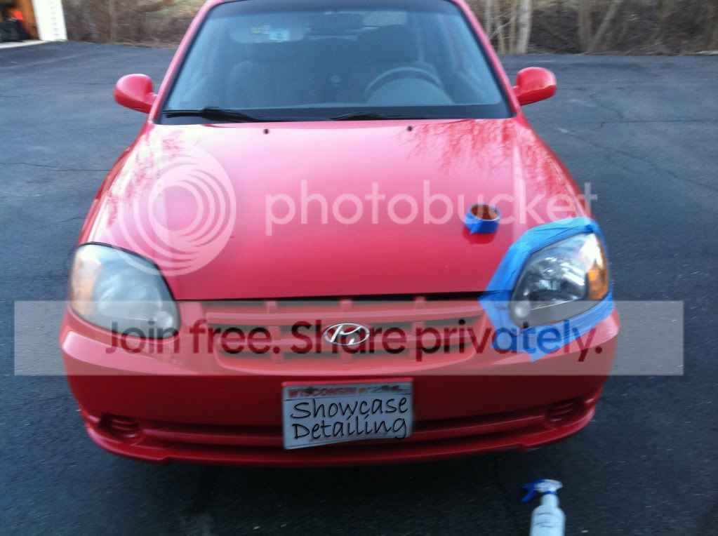

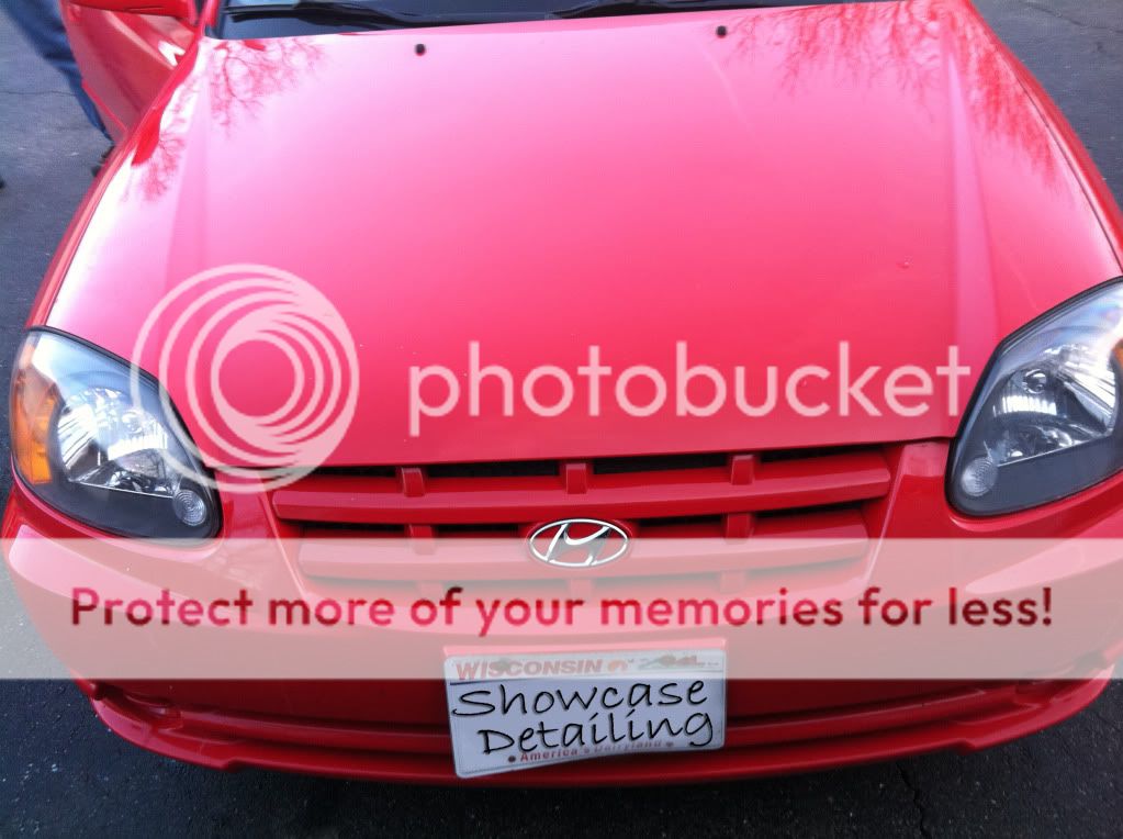

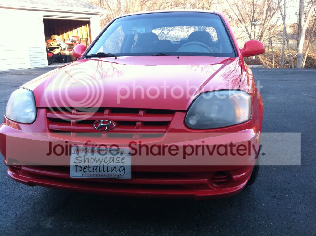

Hey all, just did a headlight resto and it turned out pretty good.

much better man !! probably got 40% more light output now !!

I had to wetsand the headlight and buff, polish and wax.

As you see in the pictures I masked off the hood and surrounding paint. Then wet sand with 800 then follow that with 1200grit. You should see a pasty white that's what your looking for. Follow that with your megairs.
