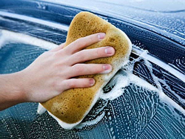

5 The Best Carwash is a Hand Wash
"We recommend hand washing," says Mike Pennington, director of training at auto-surface-products giant Meguiar's. "Our customers enjoy doing it. It's not a chore." Hand washing gives you a chance to experience the tactile shape of your baby, and it's also a great way to inspect and familiarize yourself with the car's surfaces.
But, Pennington says, don't be like the 60 percent of the population that uses dishwashing detergent when washing the car. It gets the car clean, but strips any protective wax coatings, exposing the vehicle to possible nicks, scratches, and stains. A carwash solution will preserve your car's finish.
When water evaporates, it leaves minerals and dirt on the surface of your car. So when you're done with the wash, dry the surface with a rubber-blade squeegee. One example is the California Water Blade, a large silicone squeegee that some of our photographers use to dry cars quickly during photo shoots.

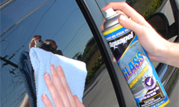

10 Make the Glass Shine
Clean the glass last, because it will have grime and dirt from the other steps. And find a glass cleaner without ammonia, which most household glass cleaners contain. Ammonia is bad for vinyl upholstery and the instrument panel. Plus, it stinks.
You'll get the best look if you buff glass with a microfiber cloth, which does a great job of getting rid of cleaner residue. That residue, as well as oils from your skin, causes streaks and spots on the inside of windows. Clean glass also looks great. Pro tip: To reach the inside of the rear window on sedans and coupes, use the back of your hand with the microfiber cloth and you'll find you can get much farther down the glass.
11 Details, Details, Details
Remember to roll the side windows down slightly so you can get at the top edges. Sometimes glass must be polished because minerals have been deposited and need to be physically ground off by a pro. Many detailers wax the rear and side windows to protect them from being etched by water stains.
Don't put anything on the windshield except Rain-X, and follow the instructions to apply it, a process that's similar to how you apply wax.
