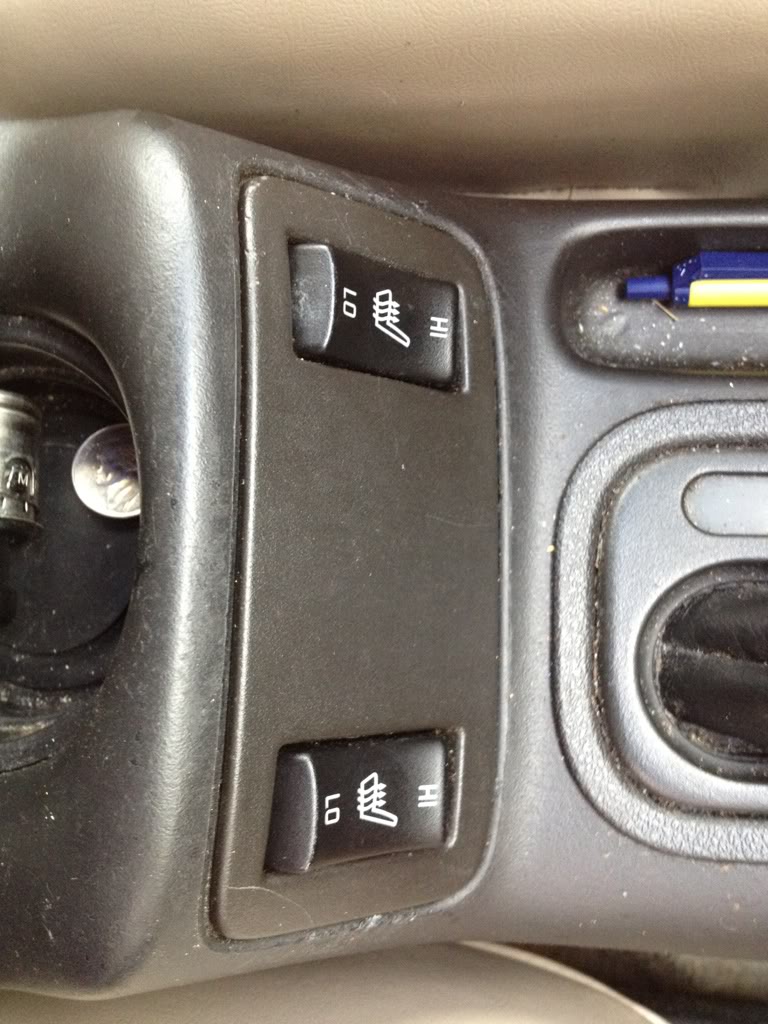

Mike 00LS Feb 17, 2013 02:59 PM
1 Attachment(s)
Originally Posted by walkingonabullet (Post 528969)
the 6th gen didnt have heated i dont think? i dont know where the button would of been.
They definitely did. 6th gens were in the console.
Attachment 34048
walkingonabullet Feb 17, 2013 07:45 PM
so thats what that was for! i knew it was for osmehting. i always wanted to use it for knobs for something i was going to do XD it comes off so easily could put tons of stuff their.
