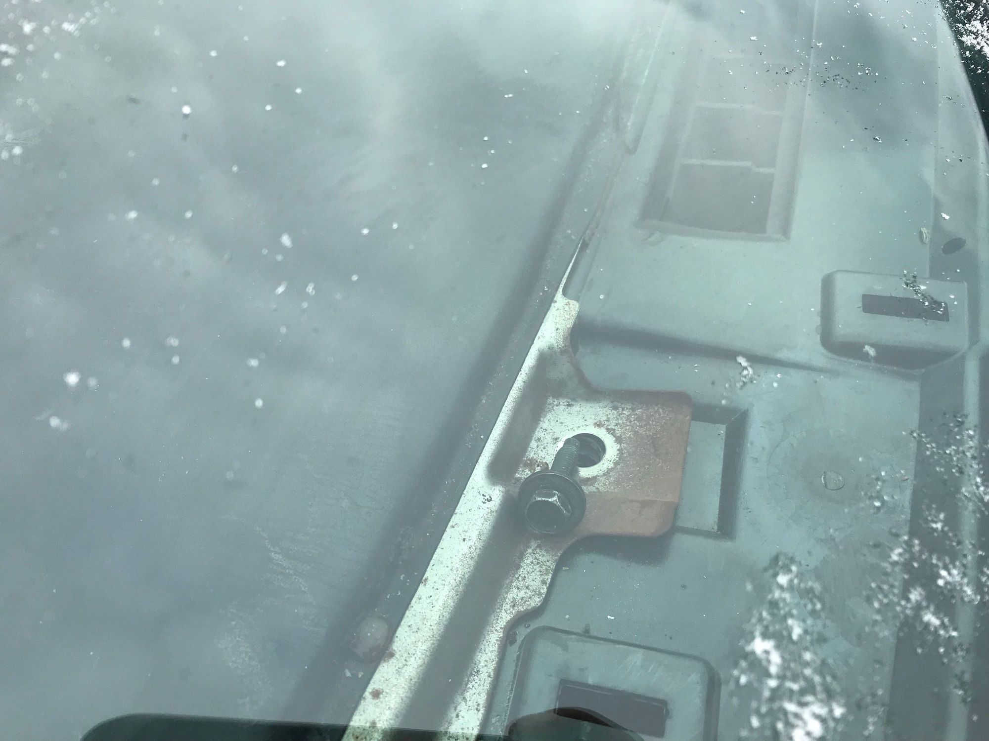

I did this to assist member 96Z34man. I know he has been concerned how to remove the bolts from the dash pad that are between the dash pad and the windshield and there is limited space.
In a recent trip to the junk yard with a friend this past weekend, I did an experiment. I know I've taken my dash pad off my Monte years ago, but I had home field advantage with all my tools. My friend and I recall we pulled a pad with the limited tool kit I take to the junk yard (I try hard to travel light, so I bring the most common items in a tool bag and some extras stay out in the car). In this tool bag, I do not carry a typical ratchet, I carry a Harbor Freight ratchet with a swivel head. I brought a regular Harbor Freight ratchet (which actually resembles an old Snap-On ratchet). My friend grabbed pics.
For the first 1-2 bolts, I used the wrong ratchet, I used the swivel (which has a very fat head on it). But, for the record, I removed all the bolts with both ratchets (either one works fine), a 1 inch extension and a shallow 10mm (I did not test a 10mm deep, but, I bet with that you would not need the extension).
We did not time this event, but freezing, I believe it took 5 minutes to remove all four bolts successfully.
Attached are all the pics from this exercise. You will see a pic of each bolt installed, me working on probably each bolt and eventually, the bolt sitting beside the hole it came from.
For anyone curious, I hope this helps.

Thanks, I appreciate the effort to take and upload all the pics. I do have two questions.
1. Why aren't there any pics showing the A-pillar trim pushed out of the way? Was the piece missing from this car?
2. What is the thing with the black handle and the wire that's lying on the dash in a couple of the pics?
The_Maniac Dec 13, 2017 11:49 AM
Not sure which picture you are looking at, but if you are talking about the black object with the green and white, that is the photocell. Is snapped into the trim piece that sits between the dash pad and the windshield. There is a box with a white lid also between the dash pad and the windshield. That box is the keyless entry receiver module.
As for the a-pillar trim, I was not aware that was still in question, hence why I did not worry about taking pictures of it. But the a-pillar trim was there and required being removed in order to pull up the trim that sits between the dashpad and the windshield. There are no screws holding the a-pillar trim in place. It's all plastic tabs. If you open the door and follow that trim to where it is overlapped by the trim for the interior rear quarter panel. Even though I have removed the A-pillar trim on my car multiple times, I don't have a "best way". When I was at the junk yard, I began from the back of the trim and tug downward to pull it out of the portion that runs along the roof edge. It is very flexible and can flex out from the rear quarter trim piece (as there is only a very small overlap). Then when you get to the pillar itself, it pretty much pulls forward and out. Because I have done it multiple times, I can normally pop it out in about a minute. Putting it back in takes a little patients as to not force it in and bend/snap any of the tabs.
