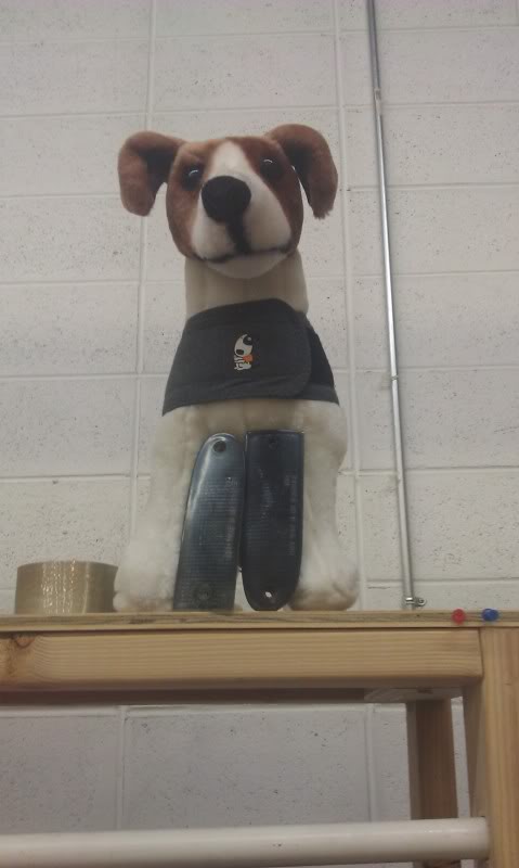

Received them at work had my dog guard them

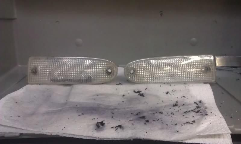

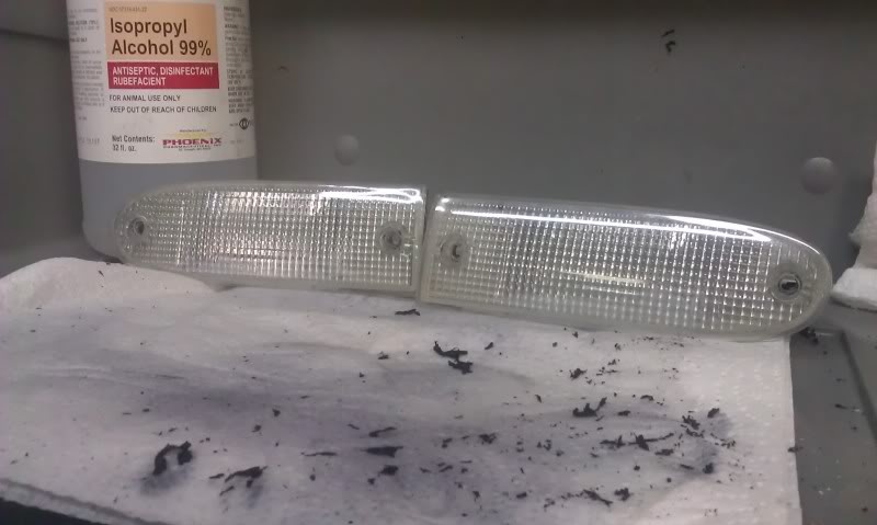

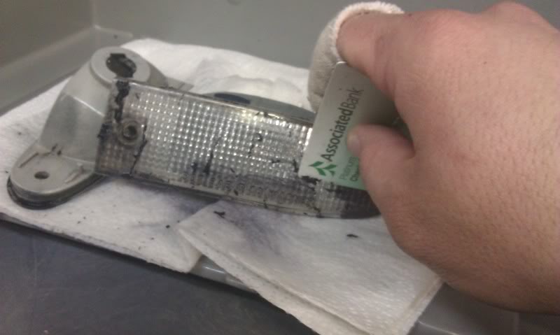

so got to work soaking them in 99% isopropal and used my card to remove the paint

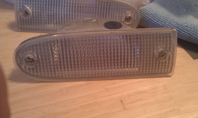

used a nice sharp razor blade to remove the lettering that was on the lenses

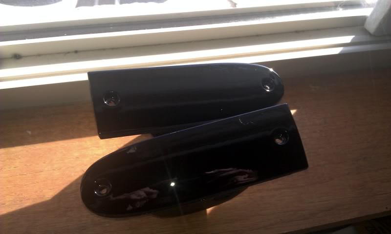

Prepped for paint

in the process of painting(vht night shade plus clear)

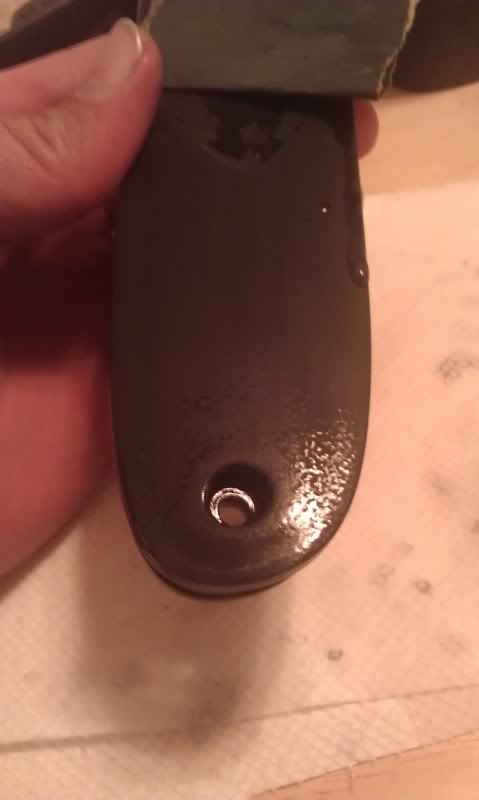

wet sanding to get them nice and smooth

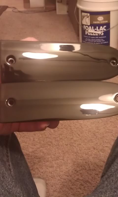

buffed out

Wow those are like glass, nice job on the rehab of those! How many coats of Nite Shade did you apply?

3 last one was a little thick so it was more like 4, and a good 6 coats of clear so i had plenty to pull off in my wet sanding

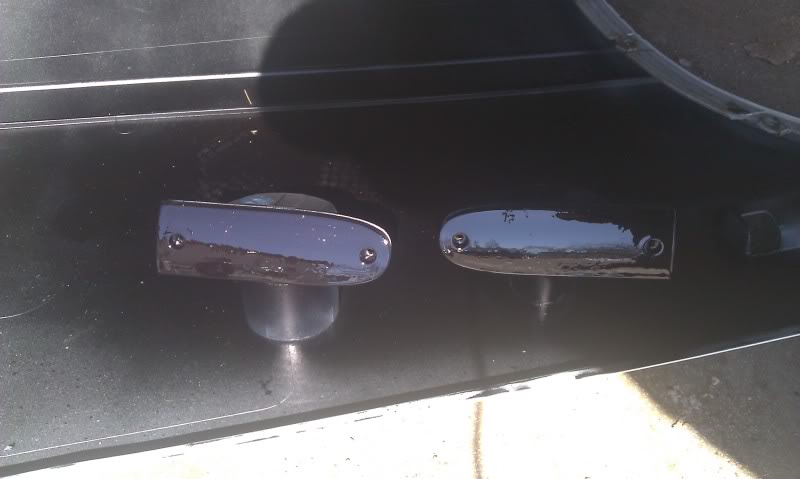

Comparison between stock and done, actually tried to pop one in to see how much light would pass through.. broke my torx bit so that didn't happen lol
