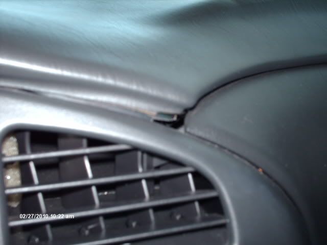

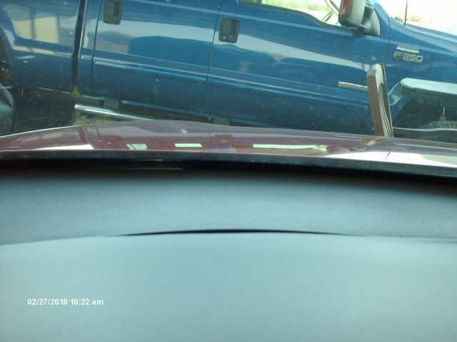

Old Feb 27, 2010 | 09:37 AM
70monte1's Avatar
Posts: 702
The dash on my 2004 SS Dale Jr. car is doing that. It also looks like its slightly coming up where the defroster vents near the windshield are. This car was also garaged most of its life. Here are some pics.

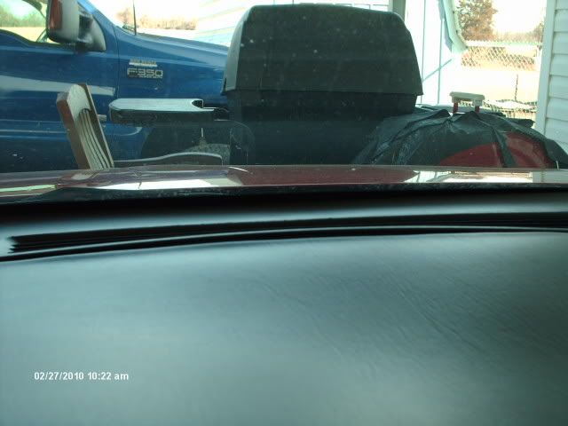

Old Feb 28, 2010 | 04:49 PM
bassplayer92's Avatar
Posts: 24
From: Kanas City, MO
Here are my dash pics. It's kind of hard to see, but the dash actually warped downward like it melted then it curls all the way back up facing back. This is the middle, but it's also a little warped close to the drivers side where the two pieces meet.
